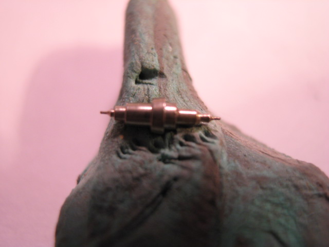

I know this is a shot in the dark, but this double roller staff is roughly 5.69 mm long. It was in a tube marked 992, however, the 992 (434 DR) is roughly 5.34mm.
It does not measure out to be a Hamilton 18s DR, either.
And the Bunn 1506 staff is roughly 5.33 mm, too...
Anyone, anyone - David, Jim, Chris ?

How about a 992E or a 950E. They are listed as 5.70 mm.
RR

Hamilton 659

It crossed my mind, but I only found the length of a 659/607048 (old #s), and not a picture or other measurements. In theory the staff would fit a 4992B (950B)...
Would you have the specifics for the measurements of the 659/607048 staff or picture of what one would look like? I did a inet search and no pics...
Thanks Eugene and RR for helping....

His looks more like a 992B, and mine looks more like a 992 (434 DR, but a tad longer)

Click on [Pocket Watch Balance Staffs] once you go to the link. Then you can down load the list.
