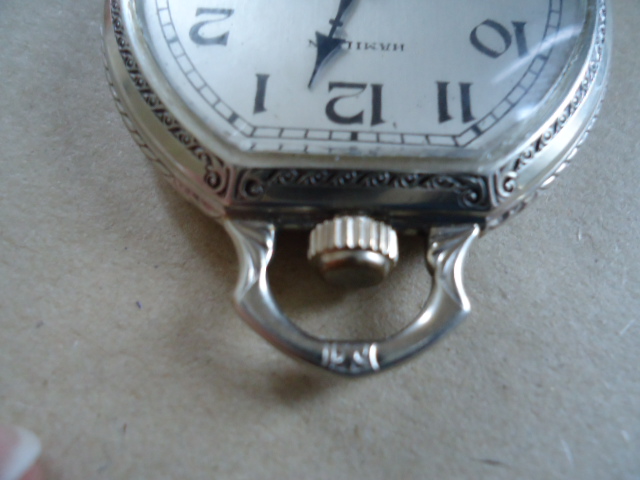

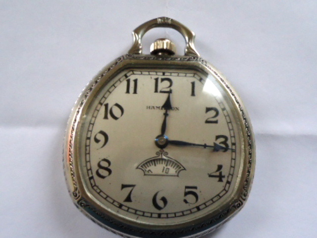

How to set the hands on this watch,don't want to force anything

watch face

the pendent is very hard to pull out and I don't want to force it any ideas.
February 19, 2014, 14:53
Claude Griffith
I have found some pendant sets that from a lack of service and or a dirty or rusty stem/sleeve getting the pendant to pull out is difficult at best. Sometimes I will pull while rotating the crown and see if I can slip a bit of oil down the stem and once you can get the pendant to pop up remove the movement and remove any excess oil so that it does not go doing into the movement itself.
