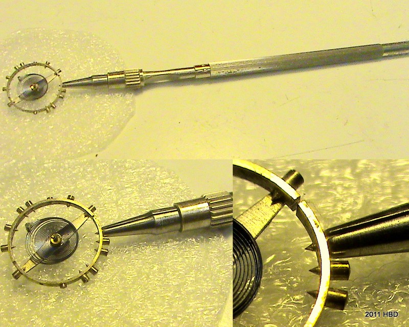

While looking at older posts on "running too fast", I came across the solution to my problem. I have a Hamilton that is running WAY fast. There is a balance screw missing exactly 180 out. I do have an extra balance wheel of the same type. How is this done? Does the wheel need to be removed from the cock? What tool is used to remove and install these tiny screws? I'm very new at this but want to learm. Thanks for any help. Paul
July 22, 2011, 12:38

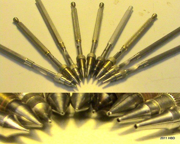

David AbbeIf you have a Balance screw holder I suggest you remove the wheel from the Cock and carefully unscrew BOTH of the New screws from the parts wheel, and then replace them in opposition to that "orphan" left on your "good" wheel.
DO NOT TRY TO USE A SCREW DRIVER!July 22, 2011, 12:45

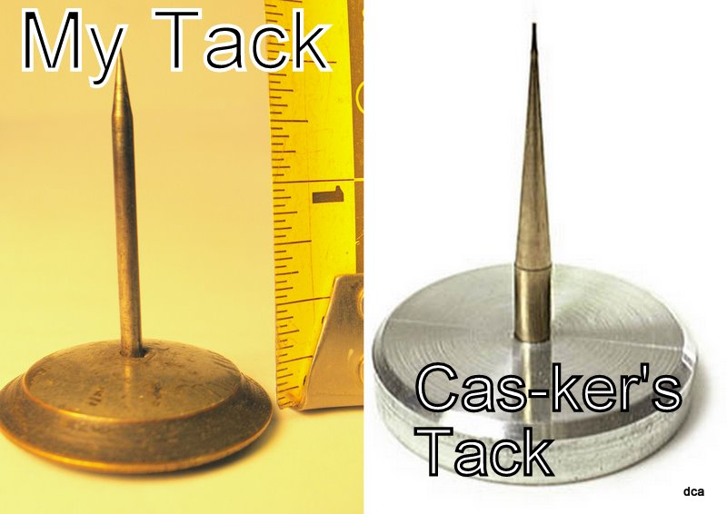

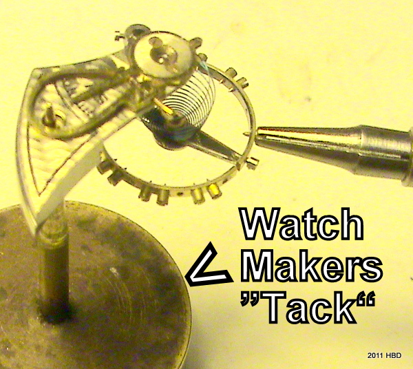

David AbbeIf you have a "Watch Maker's Tack" you can do that this way, but take care to hold the wheel so you do not bend or distort the wheel . . .

David Abbe16-18s Balance weights are about 1 mm diameter. A holder within a range of 0.25-0.8 mm will probably work. The larger they are, the less likely thay are to mark up the weight. The one I used in the pictures above is at the far right.

Gary E. FosterDave, could you show a clearer picture of the tack. Thanks.

David AbbeMy Tack That I use at home that has "Meuller" engraved on it. These were often one of the first things a budding student watchmaker was taught to make. You can buy very good one "Ready Made" from casker at;
http://www.jewelerssupplies.com/product6651.htmlJuly 23, 2011, 01:55

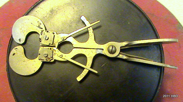

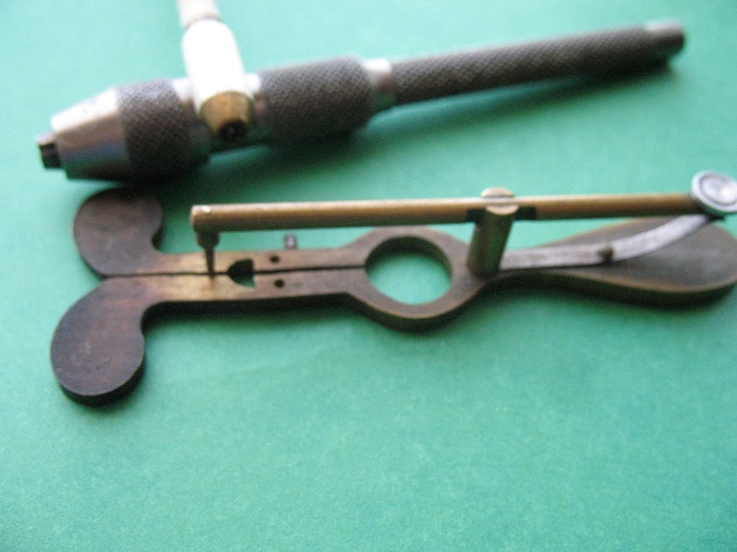

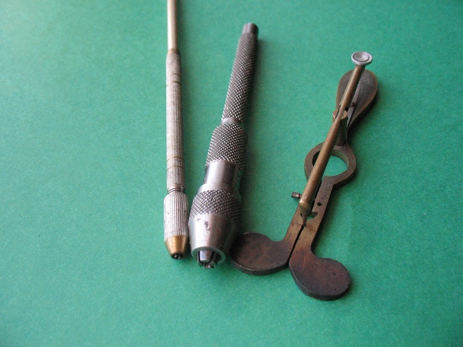

Mike HodgeIf anyone needs balance wheel screws let me know. I have a number of them of various sizes. Dave, I have some tools I was wondering about and they may be the ones you show here to remove/replace the screws. I'll post a coupe photos when the sun comes up and maybe you can tell me about them.

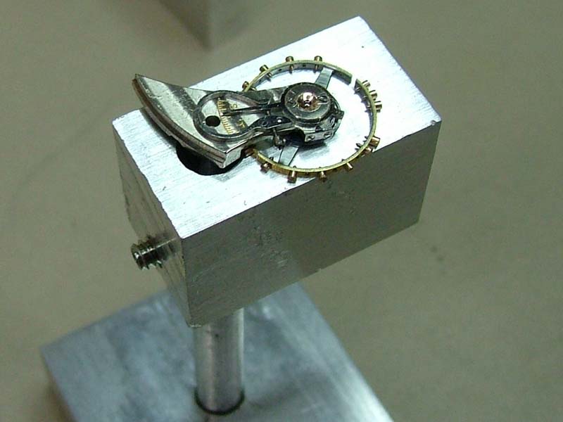

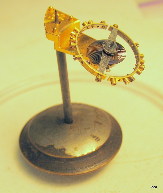

Paul ArsenaultDave: I have two screw holders on the way. I made this tack and installed a support for the wheel so the pivot and spring do not get damaged when working.
July 23, 2011, 12:40
David AbbeThe block is a nice idea Paul, I would drill a 1/2" diameter hole in it to allow the Balance staff pivot, Roller Jewel, etc. to "drop" into the hole so only the wheel rim is touching the block so no damage is imparted to the fragile pivot or roller jewel.
Usually I prefer the balance wheel is hanging by the spring so I can hold the wheel gently while working on it. If I want the wheel stabilized, I turn the whole thing "upside down" so the wheel stays on top of the Balance Cock.
July 23, 2011, 12:46
Paul ArsenaultDave: It can't be seen in the picture but there is a hole for the roller table to drop down into. Paul

Mike HodgeHere are the tools I referred to.
July 23, 2011, 15:07
Mike HodgeAnother angle

David AbbeMike, you have two pin vises for small drills and things like that. They are hard to imagine for balance weights because they would be difficult to "unlock" from the weight without stressing the wheel threads when you are done. The third tool looks like a pallet fork sdjuster with some parts missing. The separate heating tabs were intended so you could heat up each side to manipulate that stone only without having the other side floating about due to the shellac type adhesive holding the stones which softens with heat. The little "trigger" is actually a device to Lock down" the pallet lever by its pivots. Another example is below;

Mike HodgeI'm too old to learn all this stuff! Thanks Dave. These were some of the tools in the bench I bought last month. I will eventually figure it out.
