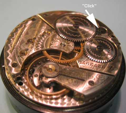

David AbbeAs the motor wheel is only connected to the main spring via a torque spur on its inner "hub", all you have to do is wind the spring into the motor barrel, insert the motor wheel so the spur connects to the inner spring end and Viola, you have a motor ready to insert the arbor into for assembly to the movement!
August 03, 2008, 18:11
David AbbeThen all you have to do is drop the main wheel on, assemble the barrel cover and install the winding wheel so it connects to the top square end of the motor arbor. Thusly, the motor arbor carries the "winding" of the mainspring through the hollow shaft of the motor wheel and to the connect with the motor barrel where it winds up the main spring. The winding is then held by the Barrel Cover "click" engaging the winding wheel.

David AbbeAll Buttoned up!

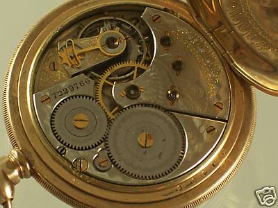

Finally found a nice one, only 11j but a nice watch,
#7229766

David AbbeEd You got the "Creme-de-creme" of that run of 1888's with that being a "Royal 17 Jewel" grade 28 that is not even listed by AWWCo. in that run.
It will clean up real "Purdy"!
You will enjoy this watch very much for its reliability and simplicity. Also the cases tend to be all original to the watches because of the "FYI" things you should know about the movement;
1. It is a 17 size and only fits in special cases.
2. It is a "Pinned" movment, (similar to the KW type) requiring only one case screw, and it will "tilt out" at the place where the case screw is removed because the pin holds the movement in at the opposite side of the case.
3. Do NOT try to tilt it out until you have released and removed the winding stem by unscrewing the small locking screw out to it's internal "stop", and can remove the crown and stem. THAT releases the movement for safe removal.
