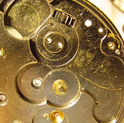

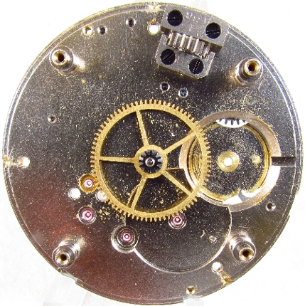

Had to take the pictures. Chris I tried using the pegwood with both the one dip and the formula 67. I have not tried alcohol. I will try that while you both look at the pictures.
The dried caked on oil looks yellow in person and in these photos.

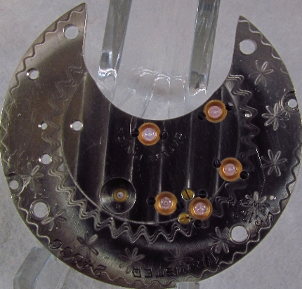

January 20, 2012, 21:20

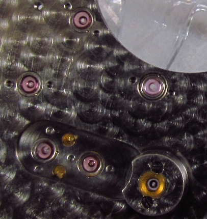

Harry J. Hyaduck Sr.
The other side.
January 20, 2012, 21:54
Jared Brinker
Harry-
If you're talking about the yellow areas, that is actually where the platings on the brass plates has been worn off or is missing. That is the brass showing thru from underneath. The areas look clean to me.
Jared
Well do I feel STUPID! After looking at the photos that yellow looked more like brass than it did with my opti-visor so I got out my 20X power loop and it is brass. I did not know that these nickle movements were just nickle plated. I did not know they were brass. It now appears to me that this is a very worn 934.
The roller table was so worn that the half moon notch is all but worn away. That is probably why it was over banking.
I tried putting a 974 roller table on but it locks the pallet fork up. I did not think it would work but I did not and do not have and extra roller table for this 18s.
Please give me your honest opinion. You cans see how worn and scratched this plated is. The roller table has to be replaced and this PL 934 is also the watch that at least one and maybe two of the dial holes are stripped or damaged. The regulator arm had one of the tiny brass pins that hold the hairspring in place broken. I have already replace the pin but with all the wear this watch has do you think it is worth the effort to restore.
I don't have a lot of money in this and I do need a parts watch but I don't have another 934. The jewels look pretty good but with all the other problems I would like your thoughts.

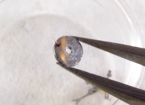

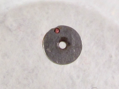

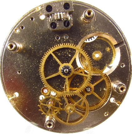

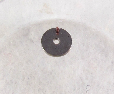

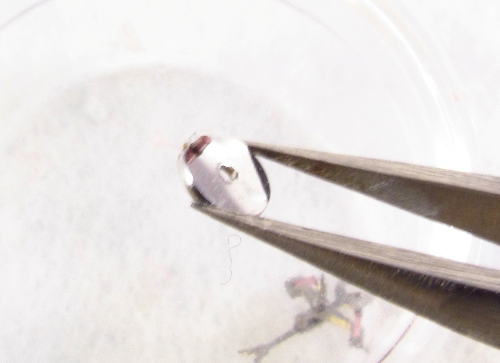

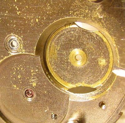

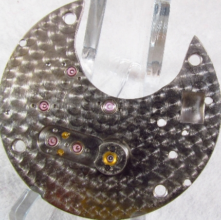

Here are some photos that I hope is what ya'll wanted to see. I took a few of the roller table. The roller table does not look as bad blown up on the camera. The roller jewel has rotated around but that is not my concern as it is loose and I can correct that. My concern is with the half moon cutout. It looks too shallow to me as if the roller table is worn. How does it look to you guys.
If these are not want you want to look at please let me know and I'll take more. Please also look at the three areas where the dial screws go.
January 21, 2012, 14:59
roller table
January 21, 2012, 15:00
another
January 21, 2012, 15:01
again
January 21, 2012, 15:02
Plate I had already started putting it back together.
January 21, 2012, 15:07
Plate
January 21, 2012, 15:08
Another view
January 21, 2012, 15:09
January 21, 2012, 15:10
Last one

Jared Brinker
Harry-
I'd get the roller jewel squared up and try her out. the over banking may just be from the banking pins being out of adjustment too. I would not be concerned about the cutout on the roller right now.

January 21, 2012, 19:31
I hope you mean "squaring" the flat spot of the Roller Jewel tangent to the O.D. of the Roller. Right now it is "Kitty-wampus" and WILL allow overbanking.
I totally concur with Jared, a 17J, 5 Digit Serial# Private Labelled Hamilton is eminently collectible!.
