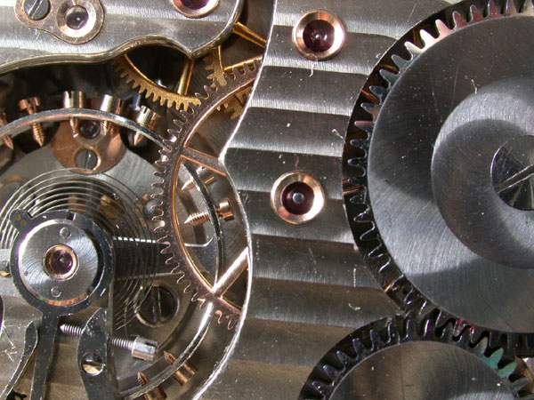

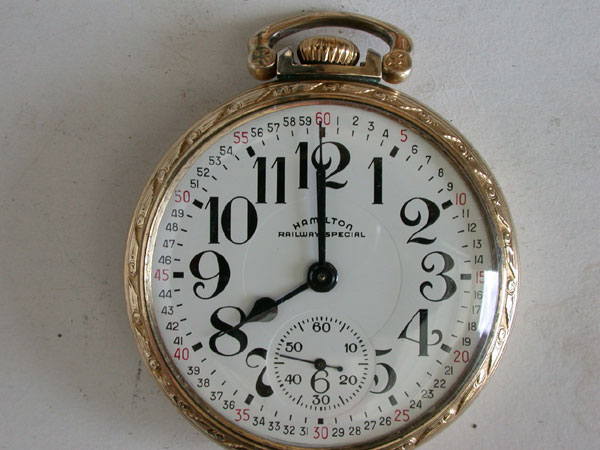

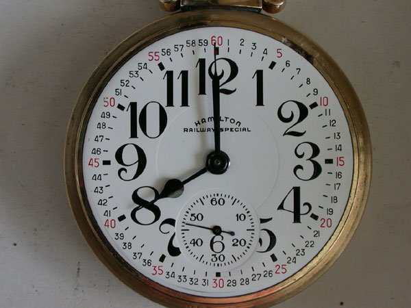

Jerry FreedmanHere are pictures of 992B. I am making three postings. One of the watch with bezel on, one with the bezel off, and a close up of the center wheel.
July 02, 2004, 17:50
Jerry Freedman2nd one.
July 02, 2004, 17:51
Jerry FreedmanLast one.
July 02, 2004, 20:02

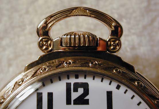

Excellent images Jerry,(Image 1) First image shows a later Case 11 without the "shoulders" we often speak of. The crown is an incorrect replacement. The right crown can be somewhat difficult to obtain.

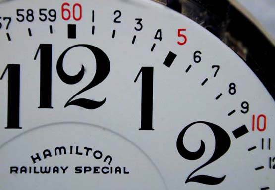

(Image 2) The second hand is from an earlier watch, of course that can be cured with a correct one. The dial is a recently manufactured S. LaRose replacement dial. You will probably want to replace that one with a correct original porcelain-enamel dial. Those replacement dials from S. LaRose are fine for a daily carry watch. They look great and hold up well, that also means we're not putting a far more valuable, original dial at risk.
(Image 3) Sure looks like a polished gold center wheel to me. It will be interesting to see other opinions on that one!
I'm sure a deal could be made to trade you up to the right dial if that is your choice.
Thanks for showing us your watch.

Terry Hillcenter wheel...
yep, looks polished gold to me also.........
but so many around this serial number have been seen without this feature, i personally feel it is a fluke... perhaps an older repair for a broken center pinion ....
the existing examples show a vast majority without the gold center wheel well below this serial number..... and above it...
I would have to see many many more examples in this serial number range with the GCW to begin to change my opinion...

This is an early Case 11 with shoulders (steps) and correct crown...July 02, 2004, 22:15

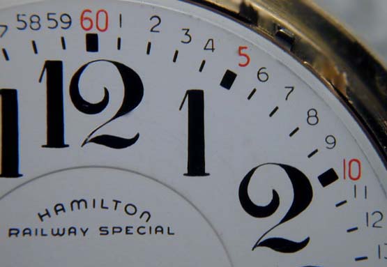

Below, here is an original Hamilton "BM Numerical" Melamine Dial...July 02, 2004, 22:17
Compare carefully, the same area on "S.LaRose" replacement dial...July 03, 2004, 01:52
Sam WilliamsonI say gold center wheel,replacement dial( actually looks better than any melamine one I've seen).To find the original first used porcelain dial will be difficult and expensive.I wish that I had bought the last perfect one I saw on e-bay 2 years ago
