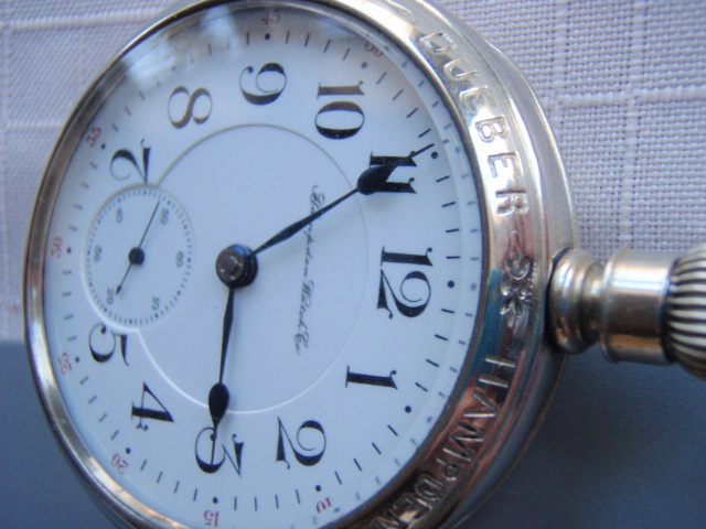

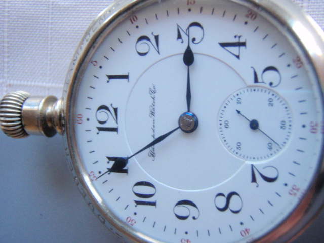

Hi gents /ladies. I'm no Hampden buff and I picked up this 23j special railway this past weekend. Any input would be greatly appreciated, like...is the dial correct? Would this movement have come in a salesmans case? My guess is probably not, and is this a fairly common case? The case, dial, hands and movement are all in great shape and the watch is running fine.

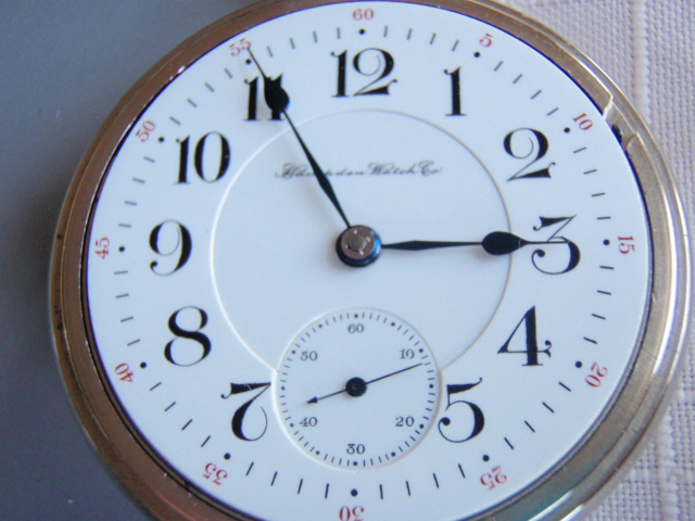

dial, no flaws

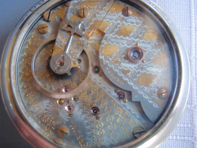

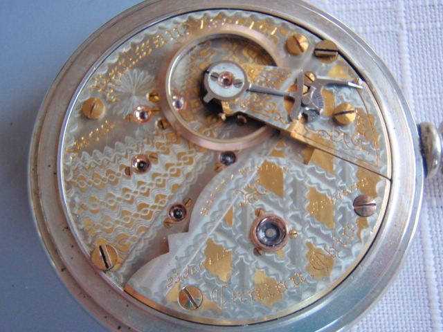

movement

Joseph I am a Hampden buff and everything about your nice watch is correct except that the case screws, while gold flashed appear to be flat heads and are probably from a 15 jewel like the John C. Dueber. They should be gold flashed but bevel head screws. Minor in my opinion and a very nice watch. By the way the designer of that movement went to Hamilton and was the designer, I understand, of Hamiltons 940 style movements. Gee, does that make Hamilton a lower quality maker?

thanks for the reply Deacon!!!!! Yup the case screws are flat, I'm just glad they are gold flashed and match. The movement is without jeweler slips and the demaskeeing is very well done,....and the tu-tone "gold" is very bold, a nicely finished movement. It sure is pretty and it does make a few of my "much more expensive" Hamiltons look like "Plain Jane". I did look through the archives and found your examples of the New Railway model, another fine example! Thanks again Joe.

Really nice S.R., Joe!I don't know if you noticed, but some blacksmith punch-marked around the minute hand hole to tighten it up.Usually, they do that on the back of the hole, so it doesn't show.You got a keeper there, beautiful Hampden...Ted.
February 29, 2012, 18:29
Joseph Pierzynski
Thanks Ted, I seen the marks but didn't know what to make of them. Thank you for pointing that out!.....Joe

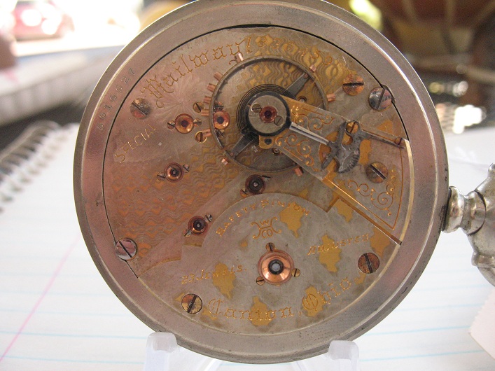

notice the difference in barrel Jewel size, the sapphire jewel on my S.P. is noticeably larger than the barrel jewel on Mike's watch. Wonder why...
February 29, 2012, 19:38
Mike Hodge
Good eye Joe. It is a different size. Someone will know!

Hey Deacon, not sure if you want my eyes but you're more than welcome to try out my glasses.... I'm not sure what serial # Mike's SR is (Mike can you elaborate?)but I noticed both SR watches barrel jewel gold cup have the same outside diameter but the gold jewel cup on my watch has a larger inside diameter which accomidates a jewel with a larger OD. Both watches sapphire jewels have the same ID at the post. I noticed that your 23j New Railway has the same larger barrel jewel.
March 01, 2012, 18:25
Mike Hodge
Joe, my SN# is 1,836,459 So I'm thinking it is newer than yours Case is screw back marked Nickel, and it's a Star Watch Case. I originally posted Silverode, but then I actually looked at it. (Don't ask me what an elephant looks like)
March 02, 2012, 11:55
Joseph Pierzynski
Thanks Mike, I think I figured this one out already. I searched around for pictures of said SR's and found that the earlier serial #'s have the larger barrel jewel, but I'm not sure where change occurred "production run" wise. Maybe Deacon can add some input considering he has a few more examples stashed away. regards Joe
March 03, 2012, 20:42
Richard M. Jones
I agree that the earlier ones seem to have the larger barrel jewel but I do not know where that left off. I just posted a list of my 23j 16s Hampden serial numbers on the Hampden site and plan to add the 18s 23j latter. When I do that I will see what I have to check about where the change was made in my collection.
