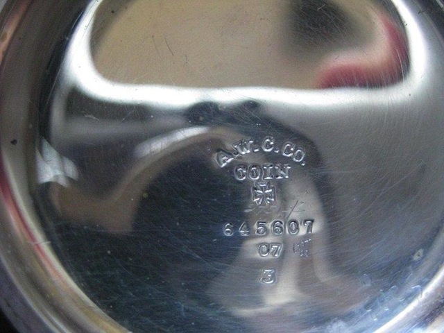

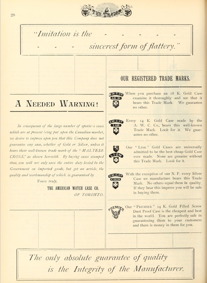

Here are a couple ad cuts from The Trader and Canadian Jeweler, 1890, for that inside screw case. Do you find, like me they are somewhat annoying to open/close?
December 07, 2014, 02:31
Lorne Wasylishen
A
December 07, 2014, 02:33
Lorne Wasylishen
The reason I asked if it was sterling or coin is that I have only seen this version.

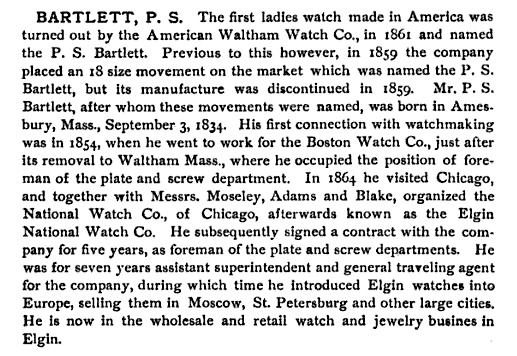

As for B. W. Raymond, the name was quite reputable for Waltham and could hardly be used by anyone else as long as they continued it's use.
Now I feel fairly sure David meant to say "Elgin" and not "Waltham", but he got to talking and thinking Harley's and just lost control and layed it down !!!
December 07, 2014, 15:51
I have a mental "Hiccup" when thinking of P.S.B. and B.W.R. Sorry. Did a little correction.

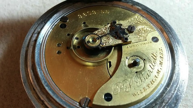

Would appreciate help again re: Waltham 18s, P.S. Bartlett
-This is a Waltham, 18s open face, yr. 1888+/-
-P.S.Bartlett on movement
-key wind and key set is on dial
-Serial# 3,603,155
-case is A.M.C.Co. Coin silver. Double hinge and offset to left & right of bottom center
-lookup site says this is Broadway Grade, No. 3 WM Ellery, Model 1883
-is this an error since Bartlett is on movement -closest I can determine is P.S. Bartlett, 15J, M#1883, KW. Is this correct?

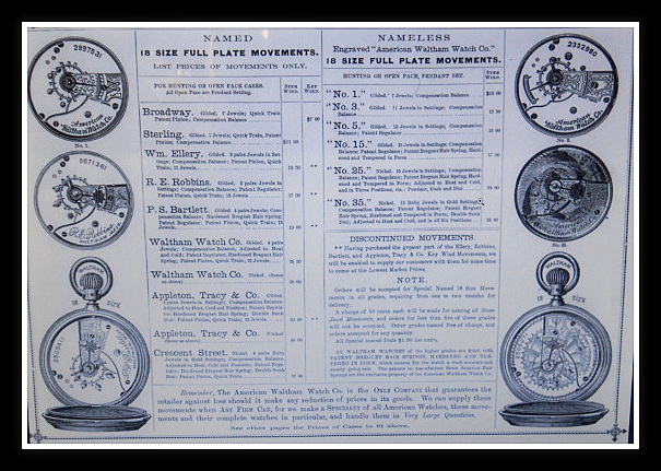

First off this appears to me to be a hunting movement ?? So let's begin from there as to what it really is.....
Secondly let me bring out my bigger guns and post/add this to my earlier posting of the Waltham Watch Co. Grades. This is a reprint from a S.F. Meyers & Co. N.Y., New York catalogue from 1887; [see attachment]
Later we will possibly remove the barrel bridge and inspect for matched/mismatched serial numbers.
Then we can start "ID"ing from deducting maybe !!

For some perspective: there were more model 1883 grades than there were previous model 1857s or model 1872s.
The A.T.&Co. grade was top quality early on, with the P.S. Bartlett grade being of lesser finish. The Nashua Division within Waltham knocked the A.T.&Co. off the top perch with its model 1860 and 1868, and did not include the grade at all in the model 1872.
The A.T.&Co. grade "came back" and was supplanted at the top by the Crescent St. and Santa Fe Route within the model 1883 hierarchy.
The P.S. Bartlett grade was always the more affordable watch from the beginning, as was the William Ellery. And although the P.S. Bartlett name (quality movement) made it into the 16 size, the William Ellery did not.
kh

That database is not infallible, Rick. I have a signed A.T.&Co that it calls a P.S.B.
But your watch is by no means a bad one! It was, by numbers sold, very successful. The jewel count is enough to make it a serious timekeeper.
There are many lesser grades.
K.
December 07, 2014, 20:47
Waltham listed this as a 7-11 Jewel "Broadway" model which was Key Wind with a fair number made in the 1857-77 series (pic.). The "Broadway" was not very common in the 1883 series. However, I would check the serial numbers of the Barrel cover and the Balance cock. The Broadway was signed on the barrel cover and had no micro-regulator wheel on the Balance Cock.
As for the movement type, because there was no winding stem sticking out the side of the movement, Key Wind movements were all generally described as "Hunter" although the actual case determined of there was a "Hunter" cover or an "Open Face" crystal Bezel.

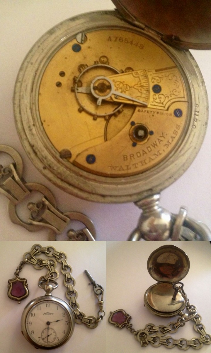

There is an 1883 mdl Broadway on eBay.
It shows the correct Barrel cover and Balance cock. That is why I questioned the one you have.
December 08, 2014, 21:13
Roger Stephens
David my Broadway s/n 3532575 has the same cock
and barrel cover as the one you posted from eBay.
Roger
December 09, 2014, 13:02
Roger, just to clarify, the eBay item was offered by someone else who offered it at an astounding price.
I only posted the pictures to affirm what I understood a model 1883 KW Broadway looks like. If yours is the same as the pictures it should be all "correct".
