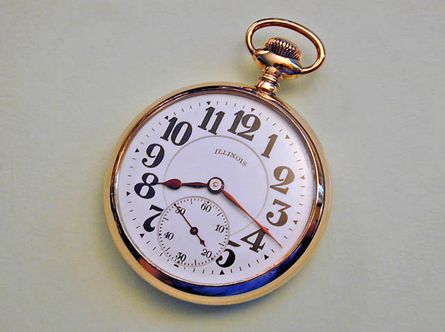

The block letter straight-line signature dial you showed might be a little old for your movement, as Illinois began phase in an arched block letter signature about 1915.
So with correct generic high-pendant case, arrows-in, arched signature dial and plum hands, your Model 9 should look similar to this:

Ed, you burst my bubble Eek.
I kind of thought the dial wasn't the right one, but was not sure.
I am glad I got it at a good price. Looks like it is going to cost me a small fortune to make it look date appropriate!
Thanks for the input.

Your dial IS a correct dial for a slightly older Bunn Special. Buy a 1913 Model 9 & you're good. Wink

Ed I can't help but like that wide chapter DSD on this watch and it looks doggone near perfect too !!
I know what you say is very correct, but since these straight line signature dials were being phased out in about 1915, and they weren't all gone from the Illinois inventory till 1919 or 1920,
Would it be possible that the dial on the watch
"may" be an original combination ?? I just think that combo is a beauty and why change it if there is a possibility it could be original...

I'm going to say I have to agree with Buster on that dial, I think it is very much correct for that movement and what a beauty it is. I say go with the plum hands as they would be correct and whatever period correct case you could find for it.

Everyone thanks for your input. I am some what relieved that the dial is correct for the time period. I do wish it looked like Ed's though. Ed and Lin must share the same time machine, there just could not be two time machines!
