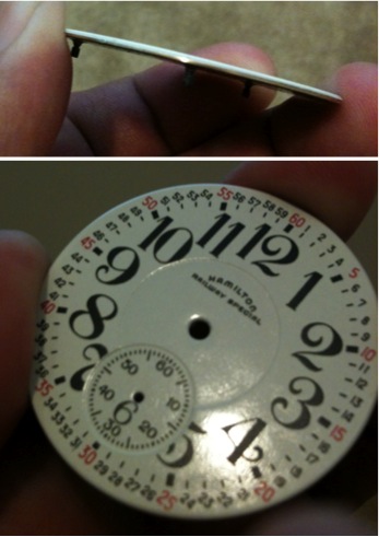

Can someone tell me the "proper way" of fixing this crack in a porcelain dial?

Well Paul, for one thing it's not a porcelain enamel dial you are dealing with. What you've got is a shrinkage crack in a melamine dial. The melamine has fractured and pulled apart, revealing the backing underneath. As time goes by the crack will get wider as the melamine continues to shrink, so filling it will only be a short-term fix.
There's really not much you can do about it long-term, except cleaning it up might make it look better. Do a search on "dial cleaning" and you will find lots of info on how to do this.

I use titanium dioxide pigment that artists use and can be found at hobby lobby and other places. The color is close and you can doctor the color with black or brown to better match. If you look close up you can still see the damage but it is not as glaring.
This is a big problem with Hamiltons, these melamine dials will age and crack and finally look so bad that parts of the dial start falling off. I tend to think that like other types of plastics sunlight (UV)causes the damage.

Ed, I am disheartened by your news that it is melamine and not porcelain, because I actually bought this watch from eBay with the hope it was porcelain…
I was under the impression that melamine dials were a single piece of melamine glued to a single metallic backing, whereas porcelain consisted of multiple pieces of enamel, glued to several pieces of metal soldered together. Also, circular indentations were sometimes pressed onto the melamine material to give the dial a “porcelain look”. The crack in this dial passes through the outer part of the dial only, indicating possibly a dial comprised of at least two pieces.
It seems that I missed the lesson “Porcelain/Melamine Dial Recognition 101”. Will you be so kind as to put me straight on this one, and explain a sure-shot way of distinguishing a porcelain from a melamine dial, just by looking at the watch face?

If you have the dial off the watch, just flip it over. If is a double sunk dial you will see all three of the dials soldered together. Two solder rings.
The Melamine dial is black on the back.

As to the backs of porcelain & melamine dials here is a picture of a porcelain double sunk [three separate pieces soldered together] on the LEFT
And the back of a melamine [one piece] on the RIGHT
Your last comment suggested that you bought a watch based on a serial number from 1940 and "hoped" it would be a porcelain dial. Dials over the past 73 years have been changed so many times that unless you know what you are looking at, nothing can be assumed, nor should it be.

Your picture of the dial that can now be seen, is a classic deeper & wider crack, that one can tell at a glance is melamine since melamine cracks & shrinks whereas porcelain cracks are not as pronounced and doesn't shrink and are much narrower. Also melamine has a condition called "checking" whereas those appear as if someone stuck a knifepoint into the dial and retracted it leaving what appears to be a small wound channel.
Also the "circular patterns" you mention are generally seen on the later crafted dials made by the likes of S.Larose. Those whirls are machine marks on some of the dies used to press/emboss/stamp the blanks down to simulate a double sunk dial on the metal blanks which are then "enamel" painted. These later crafted S.Larose & Swiss replacement dial are simply metal blanks that are enamel painted. They didn't use melamine in them. The main problem with the later replacement dials is the color fastness of the color red which fades terribly especially when exposed to sunlight.
After the S.Larose & Swiss replacements were "out of stock", some of the dial makers started offering enamel painted blanks which had no machined sink to them, another words they are simply "flat" across blanks that are enamel painted. Today these are even less desirable than the S.Larose offerings. Most of the "current" manufactured dials are flat blanks and without any sink to them. However Roll Eyes, at least one seller who I usually refer to as "bonnie & clyde" Eek, still offer the sunk pressed//embossed/stamped enamel painted RWS replacement dials. We accepted the S.Larose dials with open arms back in the 1980's as the melamine dials were beginning to deteriorate with age and that's all that we had to replace them. The "bad" of these dials is that somewhere "downstream" someone will be duped by these dials.

One thing is for SURE. We are going to need replacement dials for the later 992B and other Hamiltons. I have had and still have well over 100 of them and they all with the exception of one or two need to be replaced. Some of them are so bad that the hands will catch on them and stop the watch from even running.

Ed, From the people I have talked to, it is something that cannot be done. You have to completely strip the dial and just start over with the melamine. Which is a very lengthy process and something that very few, if any, people can do.
