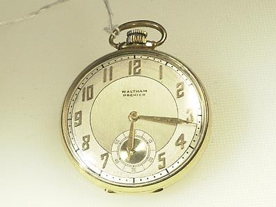

Bernhard SchmidtThe dial
Bernhard Schmidt

That's a beauty Bernhard,
Can you show us the movement?

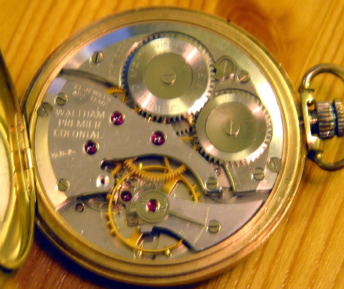

Bernhard SchmidtOk, here is the mvt, the best picture I could get from the seller.

Bernhard SchmidtThanks Jessica. Lindell you are right (as usual
)Compare to the sellers info of the size (about 43 mm, the case) it sure aint a 3/0 size watch.
As far as I understand it is a model 1924, 21 jewels and 12 size? It is not listed in "the guide" "Premier Colonial" as far as I can se.

Sheila GilbertBernhard,
Well, It looks like it certainly has the gold center wheel mentioned in the description for material in your watch. It has the jeweling mentioned too. Even though they are not gold the amount of jeweling is correct.
(see below) ****
You can't argue the NAME, it's right there on the movement.
Now, have you tried to measure it? You can use a regular ruler and use the side that says cm. Each one of those little marks in between the numbers 1,2,3 = 1 mm. maybe you can tell by that, what size it is. I use that all the time.
The interesting thing is, that they do have movements in the 2004 Cooksey Shugart book, that have different names, and look like yours with only one slight difference, however none of them mention your size watch.
Maybe it is unique! Not even listed yet. Maybe not.
The Model 1924, the colonial is like yours except one small piece under the regulator. slight diff. everything else is the same.
Page 142. No mention of the Gold though so...
The 21J is just that, there are 21 Jewels in the watch. The 3/0 is the SIZE. It means that the watch is 1 1/10 inch or 27.94 mm. round.
OF means OPEN FACE, there is no cover over the face of the watch just a crystal. It's OPEN.
The jewels on yours are not gold though.
This is what the Material description says in the glossery for your SN
"P" stands for "Positions." These are usually 17-23 jewel watches adjusted to 5 or 6 positions. They almost always have a gold center wheel and the highest grades have an entirely gold train. Usually they also have gold jewel settings. The balance wheel usually has gold balance screws, and often has two pair of gold mean-time screws. A "P"-grade balance staff may have two oil grooves and has the finest pivots. The wheel pivots are the finest used on the model.
Only the pros can help you with the above information. The size and Jewel info is correct.
Good Luck!

Ed Ueberall"From information in Roy Ehrhardt's "
Encyclopedia Vol. 1" this watch is a 12 size ,
Colonial B (which only fits a unique size case). The serial number range was 23,285,001 to 31,934,000. However, Roy does not show a listing for the 21 jewel marked "
Premier Colonial. There is a photo of a 17 jewel marked "
Premier Colonial ", and a 21 jewel "
Riverside" with the "Jeweled Main Barrel" shown on p. 70, that are almost identical to Bernhard's watch.
These watches, unlike the earier Colonial series, used only friction jewels w/o settings and had a unique shaped train bridge.
These movements used brass (not gold) train wheels and were not marked adjusted. They are of late 1940's vintage.

Jerry TreimanIn MY copy of the Waltham serial number list this movement (30,615,596) is shown as a 1924 Colonial grade no.221, made in 1940-41. This model of movement is also known as the Colonial B, and is 12-size, but thinner than the old (1894 model) 12-size. However, this movement also bears many similarities to the Colonial R (1945 model), such as the monometallic balance and the beveled edge on the movement, and may have been part of a progression towards this later movement. Waltham quality was definitely in a downhill trend by this time, and the company shamelessly used the "Premier" name to try to dress up some otherwise lackluster watches. Bernhard, note that this watch has a replacement crown and bow. (By the way, you cannot count on Shugart to list all of the variants made by most of the companies).

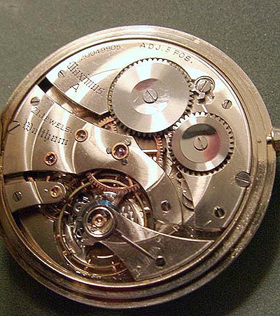

Rich KuhnHere is another example of Waltham Colonial. This one is a Maximus A 21 jewel with Diamond end stones
From the out side it is a real sleeper but once opened up a high-grade movement in a 14K white gold case.
Rich Kuhn

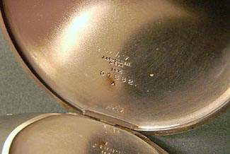

Rich KuhnPicture 2
August 02, 2004, 07:23
Rich KuhnPicture 3
August 02, 2004, 11:37
Jerry TreimanA beautiful watch, Rich. This is the Colonial A model, available first in 14-size (like yours) and a little later in 10-size. These were made only in Maximus or Riverside grades and are consistently high-quality watches. However, in the mid-20s the Colonial B began to supercede this model. At first the Colonial B was a quality watch, with a 21-jewel Riverside grade being the best in this model (and lower grades down to a 17j model), but eventually the finish deteriorated to the example earlier in this thread.
Even the Colonial A suffered a decline in finish. I have an early 10-size Maximus A with diamond cap jewels and a full gold train, and another from the last run that only has a gold center wheel and no diamond caps.

Jessica LaneCan anyone comment on the regulator, which even on the Maximus appears to be a lower quality type of regulator. I, at least, got the idea that higher grade watches always (or pretty much always) had more complex regulators, with pins etc to control finer changes. Is this part of the downward trend?
If so, what would you say the high-point years for Waltham? Is this high point generally shared by the Big Three (Elgin, Waltham, Hamilton), or is there a difference?
Jessica
August 02, 2004, 13:19
Jerry TreimanThe regulator on Rich's Maximus A is actually quite highly finished, with a rounded and polished index and chamfered edges (if you could see it in person) on the part where the regulator pins are. I suspect that Waltham did not try to use a micrometric regulator on this model because of the emphasis on thinness. They eventually did use one on the Colonial B, but that movement is not as thin as the Colonial A. The Colonial A movement came out around 1912-14 at which time no other American company had a comparably thin movement. In the late 'teens Illinois produced a competing thin movement, and it also did not have a micrometric regulator. The Elgin Hulburd, introduced around 1921, was the first very thin American movement to have a micrometer regulator.
