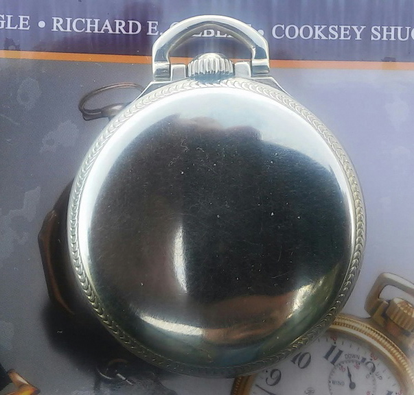

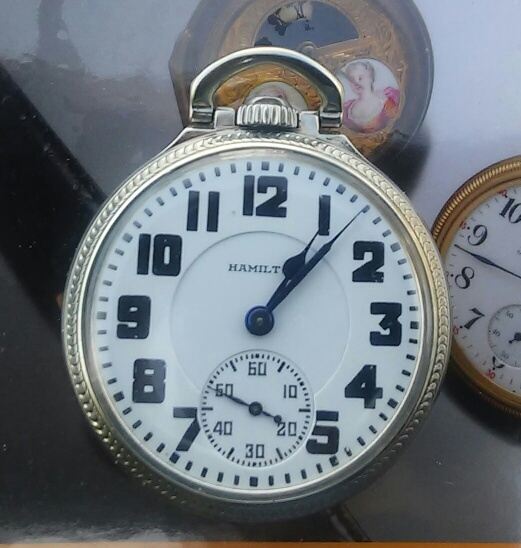

Here is my Hamilton 950 in a Star Watch Case 14k Gold Filled. It looks like the Traffic Special Case and the #16 Case but in 14k GF. Has anyone seen this case before. It was a Presentation Watch to B.F.Bardo who was in charge of the Electric Power Plant in Cos Cob, CT that powered the Locomotives of the New Haven Railroad between New Haven and New York City.

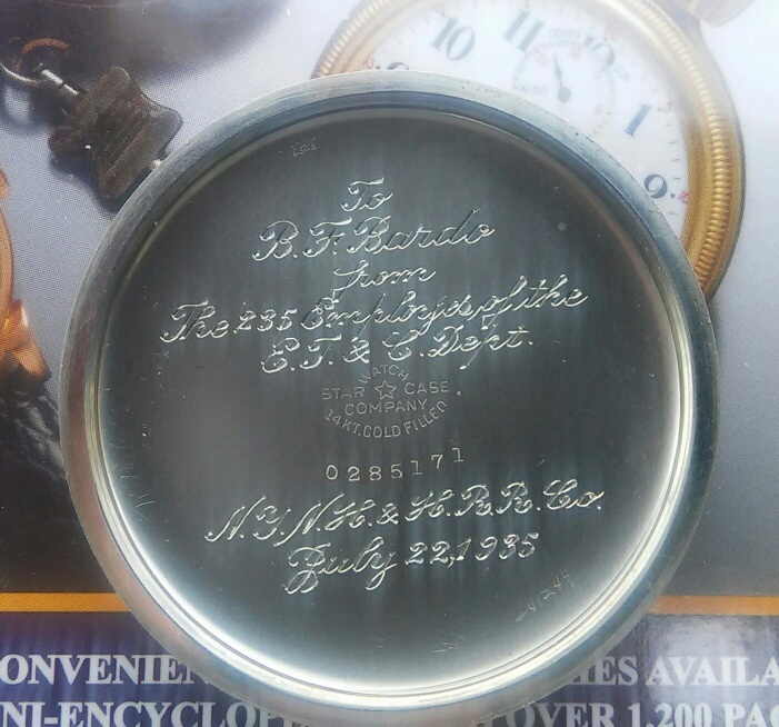

Inside Back Cover inscription

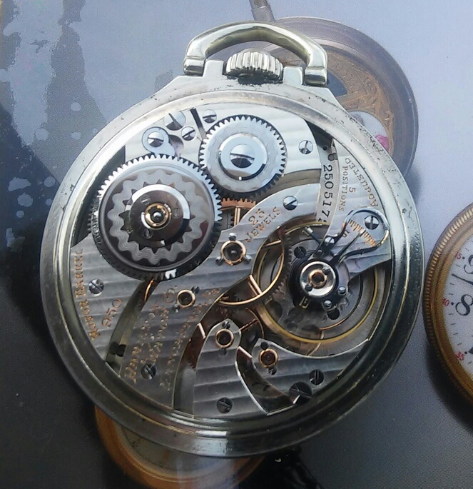

Movement Hamilton 950

Back Cover, Forgot to mention it is White Gold Filled

First, that is undeniably a “Traffic Special” case that if we go with “factory case” scenarios would have originally left Hamilton holding a "Hamilton Traffic Special” which in 1935 would have been a 974 which was a good quality 17-Jewel watch Adjusted to 3 Positions which could be carried by employees not required to carry a Railroad Grade Watch such as a 992 or 950 under the terms of their employment.
Movements such as a Hamilton 992 or 950 were Railroad Grade and Adjusted to 5 Positions which was requirement for employees who were subject to Railroad Time Service and Inspection. I am uncertain where the manager of an Electric Power Plant for a Railway would fit into those requirements, so that is where I will go with what we know mixed with a bit of speculation.
The reason we know for a fact what you have is a mid-1930s case for a Traffic Special are the markings, that "14K Gold Filled" is how Traffic Special cases were marked during that time period and that case was discontinued soon after. That is also a 1930s Traffic Special Case number, the numbers on Model 16 cases had an “R” or “P” prefix. However the case being discontinued was not the end of that particular design because in the early 1950s the folks at Hamilton felt the need for a low-cost case for their 992B and the dies that had been used to make these earlier cases were brought out and dusted off to strike the Rolled Gold-Plate Case Model 16 for the 992B which was then continued through the 1969 end of Pocket Watch production. In other words that style case in Yellow Gold-Filled was a Traffic Special in the mid through late 1930s but nearly twenty years later that same design actualy became the Rolled Gold-Plate Model 16 case.
At first glance it might be tempting to find a 974 for that case and a higher grade case for your 950 movement.
But there is more to consider…
Your 950 movement, number 2505172 dates to a run of a thousand during 1934 through 1936 production, at which time the 950 was still available to retailers as an uncased movement only, they were of course also available factory cased in a Railroad Model Case which that particular case was not. (When the 950 Elinvar was introduced in 1937 they would be offered factory cased only.) And now, this is where the plot thickens even further. You see, we are left to speculate whether the retail jeweler may have removed a Traffic Special movement from that case and sold it with a 950 movement as we see it today, the case-screw marks would line up perfectly!
What you have there is an odd combination that according to period Hamilton Catalogs would not have been available from the factory, but could in theory, however unlikely it might sound have been put together prior to the first retail sale. Some might hold that the retail jeweler may have shown the buyer for the Rail Line a catalog of cases and the case we see before us might have been specially ordered without a movement and in that instance the “marriage” of a 950 with a Traffic Special case, regardless of how unusual it sounds to us today may have actually taken place at the time shown on the inscription.
Speculation and conjecture aside that is a mid-1930s case holding a mid-1930s movement.
Much of what we consider to be "original" comes down to the exact meanings of specific words, so though your watch is certainly not “factory original” it just may have originally been sold that way... but we will never really know for sure.
Interesting to contemplate isn’t it?

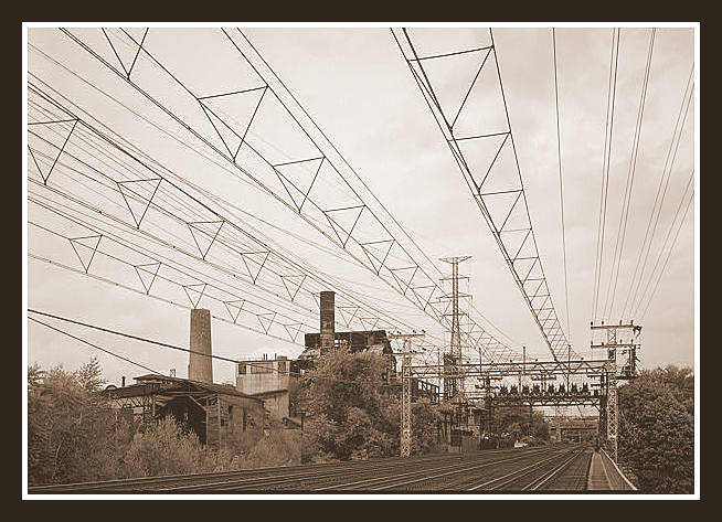

The electrification of the New Haven Railroad was an innovative technological venture. The pioneering engineers of Westinghouse and the New Haven Railroad created the first long distance railroad electric transmission system in the United States. The Cos Cob power plant supplied the system with single phase alternating current at 25 cycles and 11,000 volts. It was a successful trailblazing effort that set the standard for American railroads. On September 22, 1986 Cos Cob Power Plant was shut down and phased out.

Photo of Cos Cob Power Plant in Ct. and the transmission lines;
