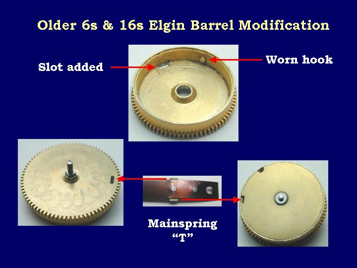

This appears to be a fine example of a 16s, Model 1, Grade 49. This watch uses a typical 16s mainspring. However, some of the older models require you to file off one of the "T" ends to fit the mainspring barrel.
The most important feature of this watch is that it can be used in an open face case or hunter case by relocating the winding pinion.
The Model 2 is another 16s model that has the three finger train bridge design. The 18s, model 6 had this design but I have yet to see one.
The attached slide depicts the mainspring barrel used on a Model 2 watch and the modification. The hook was worn on this barrel and I decided to cut a slot in the barrel to better capture the mainspring. Elgin eventually incorporated this additional slot.

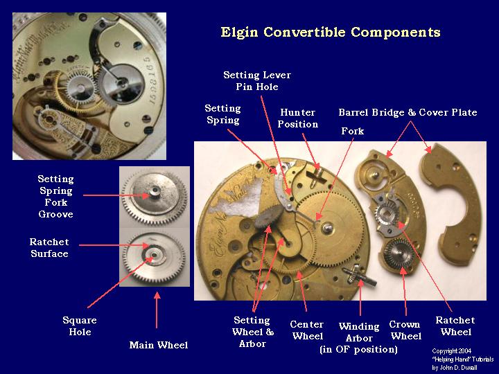

It’s difficult, if not impossible, to explain the operation of the Elgin convertible movement unless you see it in action. If you’re familiar with the operation of a conventional movement, this slide should help answer some of your questions.
Note: Compare the assembled movement with the exploded view.
As you can see, the pillar plate has two areas for the winding arbor to fit; the Hunter position and the OF (open face) position. By swapping position of the Crown Wheel and Winding Arbor, it can be “converted” to a Hunter movement.
In the “wind” position (setting lever stowed), the Setting Spring pushes the Main Wheel down and away from the Setting Wheel and causes the Main Wheel to engage the Crown Wheel. Turning the Winding Arbor will now turn the Crown Wheel. The Crown Wheel interfaces with and turns the Main Wheel. The Main Wheel turns the mainspring arbor via a square hole. The ratcheted surface under the Main Wheel interfaces with the Ratchet Wheel.
In the “set” position, the setting lever is pulled out which pushes a small pin through a hole in the pillar plate. This action lifts the Setting Spring, which raises the Main Wheel (via fork and groove) away from the Ratchet Wheel and allows it to interface with the Setting Wheel. When the Winding Arbor is turned, the Main Wheel will turn the Setting Wheel. The Setting Wheel has an arbor that extends through the hollowed Center Wheel arbor. The cannon pinion is attached to the end of this arbor. The setting wheel arbor has an interference fit with the Center Wheel arbor so the hands can be set. Under the dial, the cannon pinion, hour and minute wheels function the same as a conventional movement to drive the hour and minute hands.
