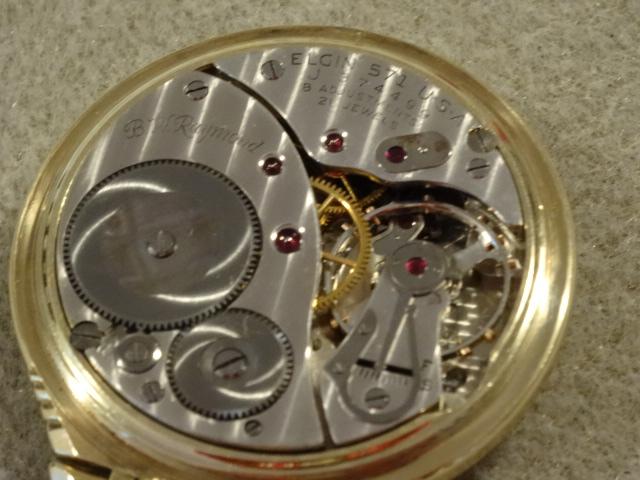

Ladies and Gentlemen, the question I have is the watch movement has a bit of movement or play in the case. Although the case screws appear to be tight there is a bit of movement. I recall reading somewhere that this not common in the 571 models but does happen.
is that so?
Serial # J374499
1948
Case #3056, serial #17799 circa 1950
I believe this is a 571-B

I don't know what could be causing it to be loose in the case as the two screws should "cinch" or draw it tight and that's what case screws are supposed to do. Could be that someone has over tightened the screws at some time and pulled the metal lip down and disfigured it and now it won't tighten down ??

Rick, another thing that you can do is to try the screw in the movement and see if it will screw down all the way while out of the case. It should "bottom out" in that movement. I have found that many times that is a problem with people switching out the screws, for whatever reason, in these movements.
Looking at your picture, the screw on the train bridge looks like it is not seated all the way, even though that part of the case rim looks like, as Buster mentioned, that it needs to be very carefully "punched" back out to where it should be. That might help with the problem.
If that doesn't work, I have a bunch of case screws and would be glad to take a look at it for you. Those movements should have no problem as far as being nice and snug in the case.

Hi Buster and Larry, thank you for your assessment.
Taking a closer look at the screw (16 power loupe) on the train bridge as suggested Larry, I think the head is tight to the edge (too big) and that is more than likely the problem. Greatly appreciated.

Rick - I have an Elgin 571 in a 3057 stainless steel case that had exactly the same problem, the movement had a slight amount of movement in the case. My watchmaker put a tiny 'case screw washer' (she had a little vial full of them) under each case screw head. That solved the problem.

With all due respect I just don't like the washer ideal/trick. If the rim is bent down from someone ridiculously over tightening case screws a GOOD watchmaker will have some tools that he/she can get under the lip and raise back up, no problem.

Tim and Rick - Tim's solution is correct for a bent rim on a gold filled case which will bend much easier than a stainless steel case.
In the case of my uncarried 3057 stainless steel case, I did not suspect bending to be the problem. I suspected the case was originally manufactured slightly undersize.
The reason for my suspicion is because the case threads are undersize as well. The bezel and back for my suspect 3057 case are tricky to start due to loose threads. This same bezel and back screw on to my other Star stainless steel cases as smooth as butter.
Extending my reasoning to the case rim, I suspected that if my case thread dimensions appear to be undersize, then maybe the rim dimensions are undersize as well.
Maybe the case maker didn't zero his caliper that Monday morning or Friday afternoon.
Regardless, at this point in time, the case screw washers did the trick for me short of replacing the entire case.

Joe and Tim, thanks for your suggestions. To my untrained eye it appears both screws are seated flush with the case rim but I think the one that is on the gear train plate (as Larry alluded to) has a slightly larger screw head...or something. So perhaps different screws. In any event the movement play in the case is minimal but it is evident and will have it looked at.
