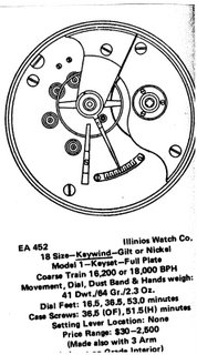

Gary, Without any pictures, I can only Guess this is an Illinois "Iowa Watch Co." which is quite valuable if you can restore it. The movement would have to be exactly as pictured . . .

From what I can find out it was made in 1881 part of a run of 1000,(numerous runs) its a model 1, gilt finish plates, 7J S18. Should have a single sunk seconds Roman numeral dial. Parts should be easy enough to get.
