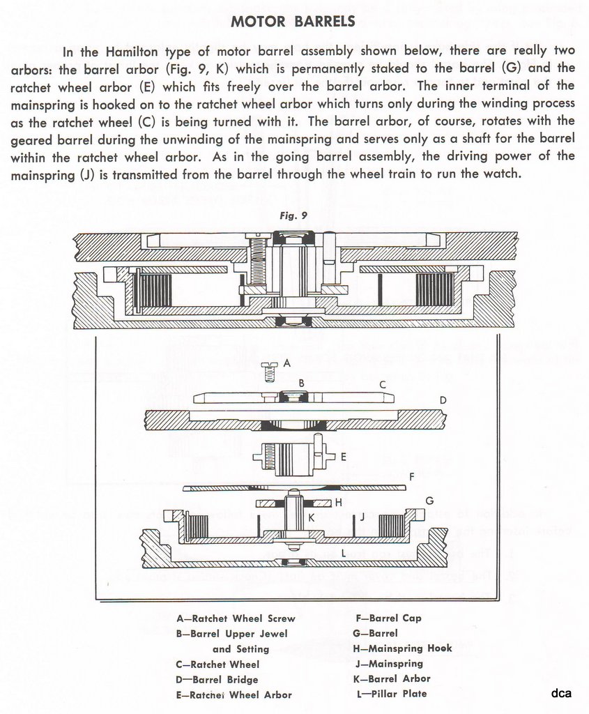

"Experts" and other people have broken into another school of thought that argue the Going Barrel designs named "Motor Barrel" by Hamilton and others are truly Motor Barrels. The Bulova school (again) tries in a very diplomatic fashion to describe the rather complex Hamilton "Motor Barrel" as follows;

Richard PfeifferIsn't this a safety barrel and though designed differently, be the same as Elgin's safety barrel as used in the 240 and 372? Safety barrel and motor barrel are used interchangeably, but I was under the impression that they are not the same.

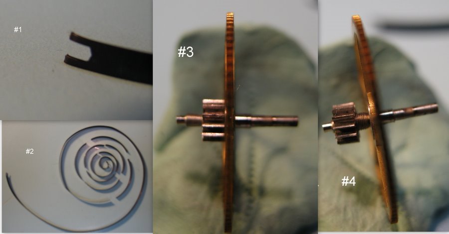

David AbbeThe term "Safety Barrel" refers to the cup or "Barrel" used on all Motor or Going barrel watches including Waltham and Elgin (excepting some Dollar watch movements) to contain the main spring so when it breaks or explodes it does not destroy the watch movement.
The "Safety Pinion" is the second protection for this issue;
The pictures below show this little jewel at work;
1. Main spring end "pop's OFF" at full wind!
2. In about 1/1000 of a second the main spring releases all it's power and in doing so self destructs (in this case into 10 separate pieces ).
3. The main wheel with it's "pinion "meshed" to the main spring barrel . . .
4. Gets hit with the enormous torque shock of the breaking spring that is driving the barrel backwards. The SAFETY PINION instantly unscrews harmlessly leaving the mainspring barrel to absorb and contain all the pressure.
Without a Safety Barrel and Safety Pinion the wheel train is destroyed.

If you look at the exploded spring I posted above, the outer hook on a Waltham Motor Barrel watch broke delivering the full force of the mainspring as an explosive shock to the center arbor which IS the driving arbor for the wheel train. When this outer hook or spring failure happens in a Motor or "safety" barrel design WITHOUT a Safety Pinion, it would blow out the wheel train. I Have seen these and posted once on IHC185 a picture of the escape wheel with escape teeth wrapped around the pinion due to the huge devastating torque shock.
