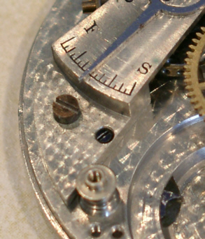

Stephan Gaal
You can see the extra screw in this picture

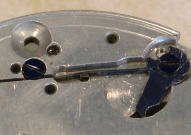

Stephan Gaal
And the other side showing the flat which acts on the spring

René Rondeau
Great pictures, thanks for posting. I'm fascinated with Lancaster watches and have several grades, but no "Ruby." I've worked on a few of them and they all have the same screw to adjust tension on the click spring to let down the power. They're very interesting watches.

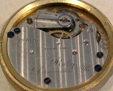

Stephan Gaal
I found a few more pictures of Lancaster watches and yes, most of them appear to have the let down screw. I have got mine together and running again. Have added a couple more pictures. It is shown in the brass inner ring of my Muckle case.
