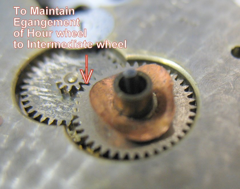

I read somewhere, (Bulova school, Fried, Chi sch watchmaking ? ? ?) that this beryllium copper "Dial Washer" is intended to keep the Hour Wheel teeth engaged to the intermediate wheel pinion, as the pinion thickness is often less than the extra clearance under the dial. (In my haste to take picture I forgot the cannon pinion Cool)
January 09, 2010, 15:53
Roger J. Nolfe
That is an excellent point David. That is certainly another reason for the dial washer to be in place. These little guys are so important, yet overlooked all the time.
