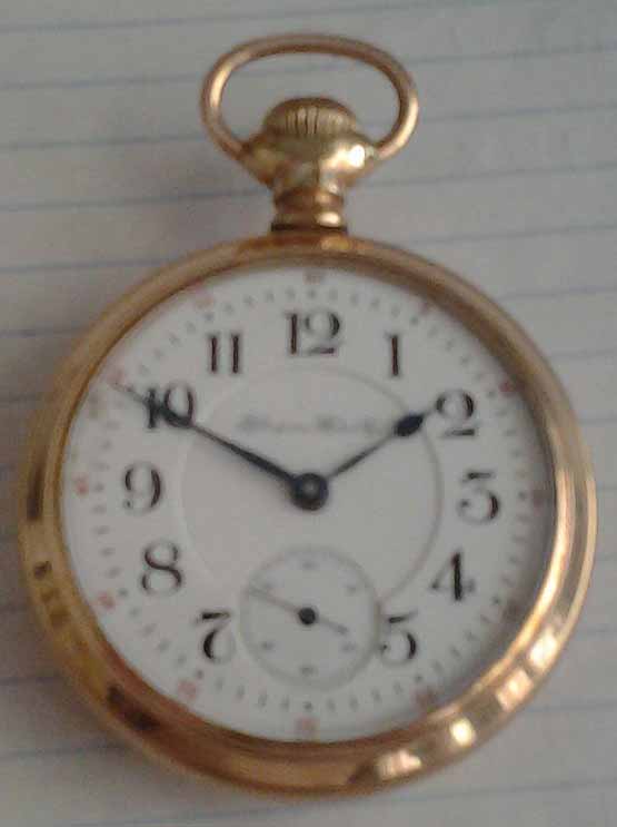

Learned another lesson on this watch too. Ready to put the dial back on and all of the dial screws are missing! (Found them in the jar of watch cleaning solution). The ultrasonic cleaner vibrates the screws out unless you tighten them up or remove them before cleaning!
This is the best picture I can get with my phone camera. My digital camera was stolen! Camera recommendations? I need a new one.
By the way this a Hampden not Hamilton as I previously stated.
It's a 3 Ball Hampden with original Dueber case.
