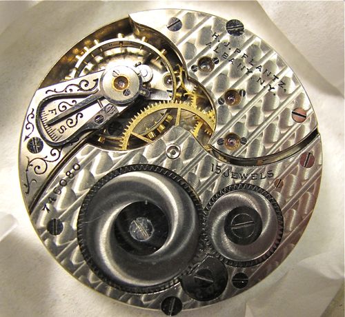

Can anyone tell me what the deal is with this private label Illinois. It is a 16s from the early 20th century, yet the serial number comes back as being a 6s, lever-set, model 1 from 1887! On top of that, when looking at the movements in Shugart's, I can't find a one that has the case screws in these locations. What gives?????

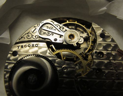

Bruce StewartHere is a close-up of the serial number.

Gary E. CochranLooks like a Rockford movement to me..That might be the problem...LOL
April 04, 2013, 21:52
Theodore J. Brown Sr.Bruce, that to me looks more like a Rockford.If that were an Illinois, the SN would be much higher.Rockford, like Illinois made a whole slew of private labels.Nice looking watch! Best regards, Ted.
Robert V. JonesI have to agree with Gary I think it is a PL Rockford
April 04, 2013, 21:53
Theodore J. Brown Sr.Looks like Gary and I were typing at the same time!Sorry about that...Ted.
April 04, 2013, 21:56
Gary E. Cochran16sz. Model 2 15 jewel Grade 586 Rockford
April 04, 2013, 22:12
Bruce StewartThanks guys! I knew there had to be someone out there a lot brighter than me. When I first saw it I thought Model 7 Illinois, but I guess the Rockford plates are really quite similar. Thanks again

Edward L. Parsons, Jr.This is the down side of movement-marked PL's, no explicit maker ID. But like Ted said, the low movement number (746080) is too low for a 16S 3/4 plate Illinois, and like Rob and Gary thought, it looks like Rockford to me too.  The dial has too many curves and flourishes in the numerals and the damascening pattern is too jazzy for an Illinois IMHO. Congrats Bruce, cool watch!
