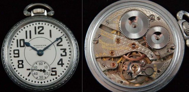

After carrying and regulating this 1932 Waltham Vanguard for around 1 month, I have already reached the "Slow" end of the scale, and still it runs 10 seconds fast per day!
This was the watch I was referring to earlier, with a quite stiff main spring.
What to do next? Am I worrying about nothing?
(The picture is when I first started regulating it).

Paul, Seeing the watch in question brings me to believe that this is NOT a mainspring issue.
First, Your watch uses a mainspring which is made especially for that motor (safety) barrel.
Second, in another post, I mentioned the regulator (especially on higher end watches) can have little or NO influence on the watch timing. In your watch which is running 10 seconds (only) "fast"/day this is certainly the case. Remember, <5 seconds/day would be within RR time standards.

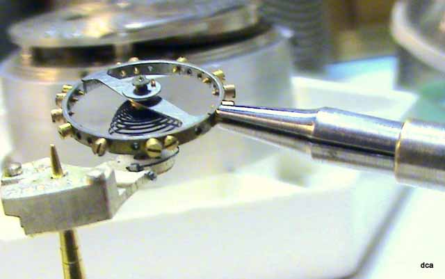

Roger, I must defer to your comments. When referring to "the tools" I did mean to imply the experience and the correct tools to remove the balance cock and wheel assembly, mount it in a watchmaker's pin and carefully hold the wheel while using a watchmaker's balance weight locking tweezers to rotate the mean time weights out 1/4 turn.
(Note, this pictorial view uses a 12s Elgin for demo only, most Elgins have no Mean time screws like the 4 that are probably used on Paul's Waltham).

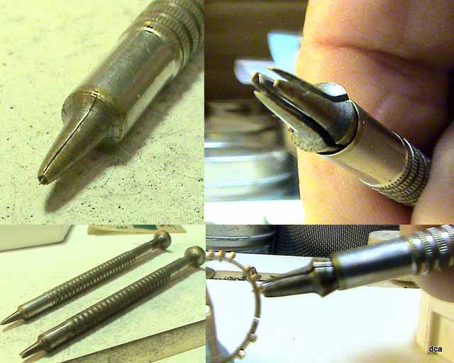

I'm sure I would be able to manage the adjustment myself, thanks to your very clear instructions, except for those neat-looking locking tweezers which are not part of my arsenal. Would it be possible to use a screwdriver instead and what extra precaution is needed?
Only the clamping type screw driver tweezers (below). A plain screwdriver can break the head off instead of adjusting the mean time screw. Then you have a REAL problem. I recommend Chris Abell first.
