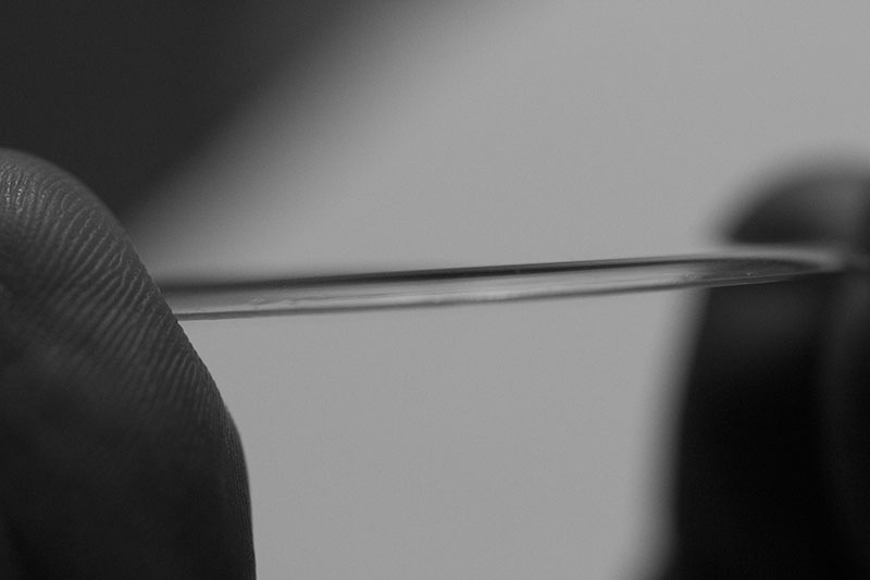

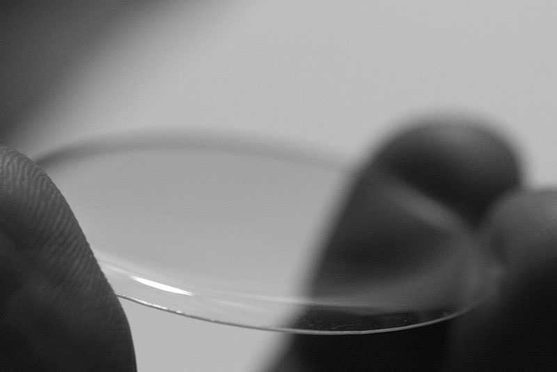

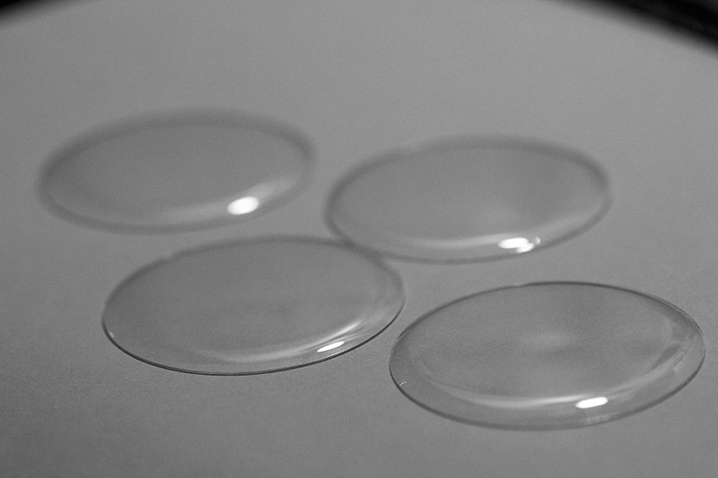

I made my very first hunting crystal this morning! My first test was a small group of crystal blanks made from 0.4mm (.016") glass sheet. This is the typical thickness for most vintage HC glass in the 12, 16 & 18s range. This initial trial went extremely well with few surprises and from the 6 pieces that I started with, 4 are usable!

The flat glass discs started with a diameter of 47.5mm and after forming they are 46.5mm. After sizing I'm guessing that a 43.xx - 44.xx would have a height of 6 or 7.

I will now need spend time recording my process variations for making the different heights as they align to diameter. The glass is not cheap but it is available. I will continue this pursuit as time allows. Availability and cost have yet to be determined.

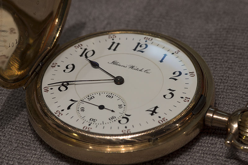

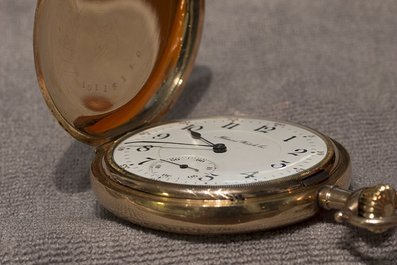

First fit/install performed on the only hunting case watch that I own. The original crystal had a large bubble which has bothered me for years! All went as expected and the fit is perfect! 41.6mm and the Inside clearance is about 1mm which would make it a H7 I guess. The glass used is 0.4mm float made in Belgium. Clarity is great. Making these crystals looks like a promising endeavor.

One more shot.
