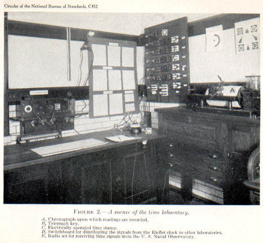

I seem to recall that horological rate recorders (or timing machines) were invented and developed by Bell Labs in the 1930s, but that's from my occasionally erroneous memory, and I can't find a source for it right now. In any event, suffice it to say that people interested in top-quality work, have in all ages sought the best technology available at the time. I very seriously doubt that today, a top-notch professional draftsman would be found working with a T-square and compasses, but that's just an "educated" guess.
Perhaps the image below of a 1930s time testing laboratory may be of interest. Note the large cylinder labeled "A," which is very similar to the much smaller cylinders employed in the early WatchMaster rate recorders:

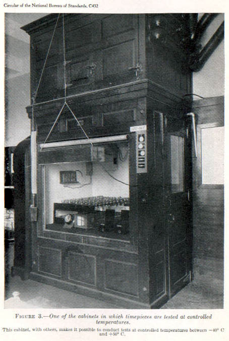

Another image from the same source as above....
This one shows a thermal testing cabinet, which is filled with trays of watches, and what appears to be at least two ships' chronometers:

Thanks for the pictures Steve, can you comment on the laboratory?, was it from a watch manufacturer, university, national lab...?, if so was it for reference testing?

The images above are from a 1941 U.S. Department of Commerce, National Bureau of Standards booklet, entitled "Testing of Timepieces, Circular C432." The text doesn't specifically say that the images are from the laboratories of the National Bureau of Standards, but I strongly suspect that such is the case.
