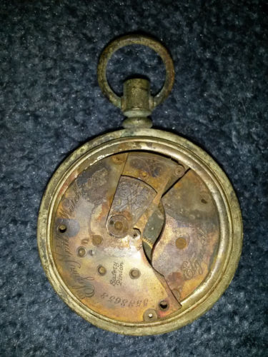

Thank you all for your interest in my project, I have been encouraged me to share this with other members so I will try.
As Paul mentioned,the watch was an eBay purchase, the seller bought it from a diver who had recently recovered it off Key West FL.The rest of it's history is unknown.

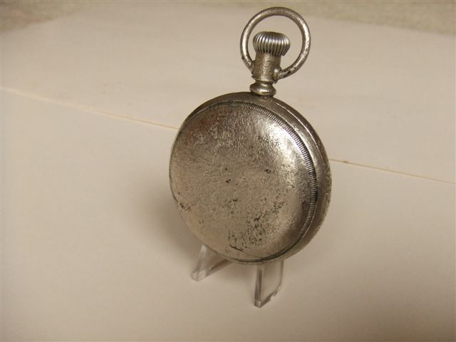

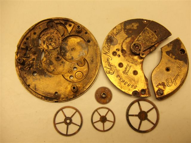

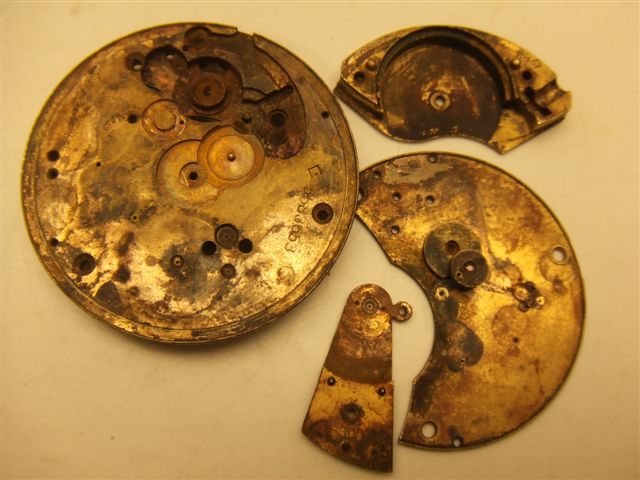

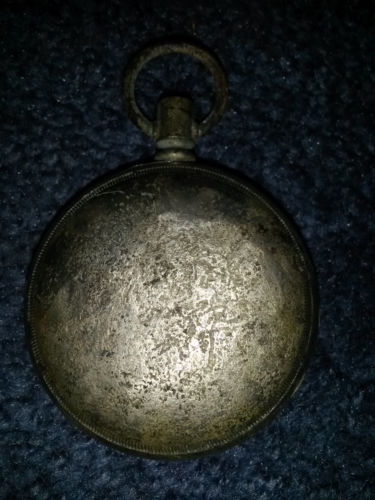

I bought it simply for an interesting display, the back cover had been pried off and the brass plates and wheels were loose inside. There were no metal or steel parts remaining. The few pieces that looked like screws were nothing but dust and easily removed with pegwood.The brass was untouched and all the threaded holes looked new. How long did that take...i am still amazed.

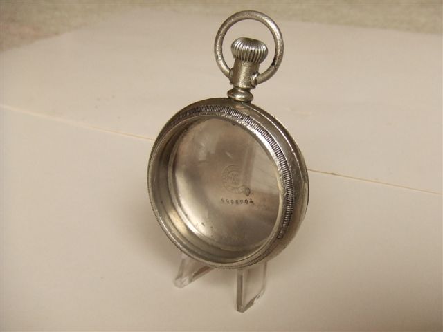

The case cleaned up well enough to accept a new sleeve and stem, even a new crystal clicked right in. It survived many soaking,freezing,heating sessions necessary to remove the bezel...who knows how long it was submerged in salt water. A Fahys Oresilver No.1 is some tough case!

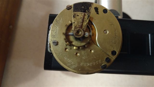

I sent the case to Paul for the new stem and sleeve with a note that he must think I'm crazy. He sent the case back with a note that he would like to see the movement plates.It has escalated from there.Paul got it running. He reconditioned the plates leaving some of the deposits as I requested but clean enough to make a reliable watch.He also supplied all the items necessary from his inventory of parts. No running watches were harmed by this project!
The watch is not quite done, I will post a few snapshots.

Bob Aliberto
BACK

INTERNALS
April 26, 2016, 14:11
Bob Aliberto
INTERNALS 2

RUNNING AGAIN !!!

Case done

Yes this is a piece of history and if it wasn't for the diver selling it and Bob buying it, we might never have seen this watch, every piece and part of this watch had to be put back together like building a new one, some of the pivot holes had to be cleaned and polished, the parts used was actually in my parts drawers, maybe 3-4 different movements that had been parts, along with a good cleaning, new main, new staff, complete, when I first put it together and got it to run it was like 635+ secs a day slow, polished some more pivots and replaced the upper balance jewel and it's down to about 313+, will replace the lower jewel and a little more polishing on the,staff and I think I can get it to under 20+ secs day...should finish it up today and will be shipping it back to Bob to install the dial,hands and install in case, then more pics and info on its running ability will be posted but may be a few days..thank you to all..

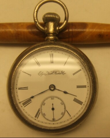

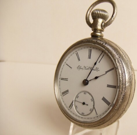

Finished watch first pic , more pics to come

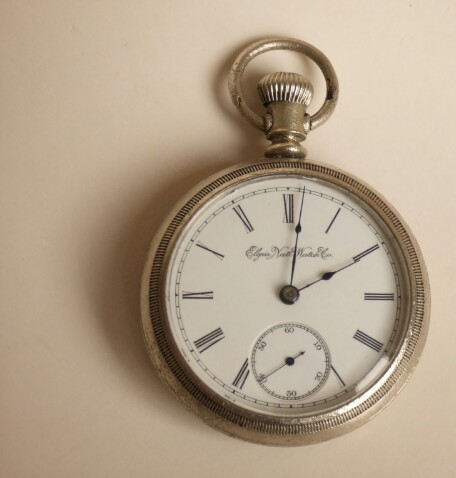

I have a different approach when restoring, do not get me wrong but I would stay with the original dial
and not so clean plates,
Great job on restoring it to working order.

Paul Davis
Finished 1

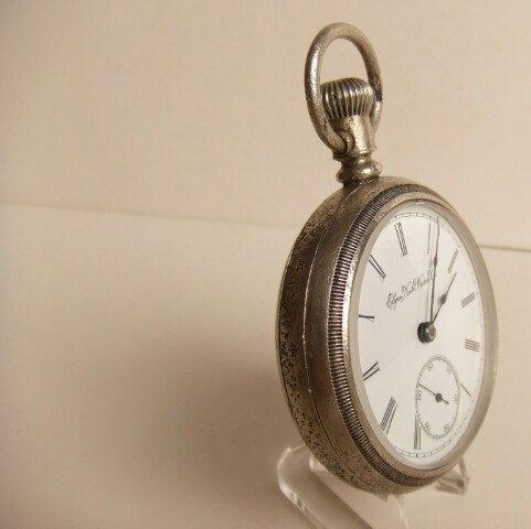

Paul Davis
May 05, 2016, 19:21
Paul Davis
Finished 2

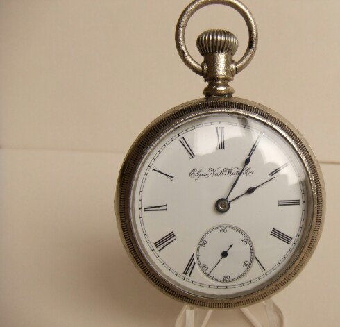

Paul Davis
May 05, 2016, 19:21
Paul Davis
Finished 3
