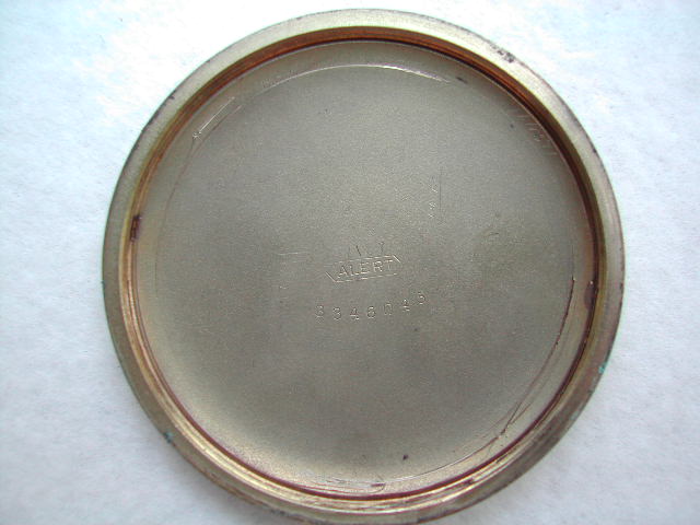

I'm a little turned off with pocket watch purchases these days as a result of info. from a local chapter member concerning my last purchase.
Seems the case is not original to the watch. It looks like one screw mark on the case. Chapter member said he thought the case was a re-plate as well. He also said the dial is metal and made ten or eleven years ago. I do not have access to removing the dial. I'm not sure the hands are correct either. I cannot tell if diamond end jewel.
I prefer purchasing an original watch case, original dial and hands etc. etc. I'm a purist at heart, what can I say. One of those spontaneous purchases and most probably my last for quite a while. Roll Eyes
I'd like your honest input.
Vanguard
23 jewels
Alert watch case
Serial # 10560085
c. 1901

Case
Stephanie O'Neil

Stephanie,
If you bought a bad watch, we all do it once... Eek ...or twice... Big Grin
Everything Ed said above is worthwhile. It's wise to carefully compare before buying, to become in tune with condition. Also a novice collector should ask a lot of questions and become familiar with searching information on our site. Having another member to consult with for guidance before buying anything of consequence is without saying a fundamental plan. As collectors we invest in condition, we get the best condition example we can reasonably find. Smile
Since you asked for an honest opinion on that particular watch, I'd say what you ended up with would of course need a decent case, (75-100 dollars) porcelain dial and maybe bold hands (another 75 or more) in order to be worthwhile. Consider first if the below average condition movement would justify those expenditures. If you started out with little enough in it, the end result could be a reliable carry watch. But let's ask for another opinion on it! Wink
