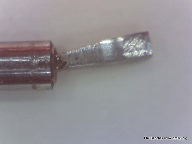

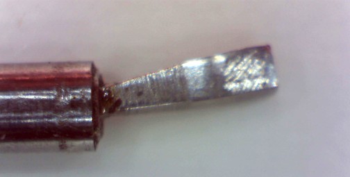

I recently got a WALTHAM s/n 13594489 and began taking it apart
The stem seemed quite strange because it was very FLOPPY.
I finally removed it only to find it had a universal joint between the square end and the rest of the stem. It is not a true universal because it will wind and set the watch. So it is somehow keyed so it turns when the crown is turned.
Has any body seen anything like this? IN my LIMITED experience I have never.

Melvin I have resized your photo. To get a better understanding you can go Here to this forum to learn more.

I have not either but find it curious. I imagine it pivots in four directions? Also, it seems like it might be one of 2 things. It was either made to allow someone to align the dial better once the movement was installed (does not seem like a high end watchmaker would make parts that do not match up. I have only seem dials be so far off if they are after market ones) or someone actually repaired a broken stem by drilling it out and making a socket in order to insert the square portion. Just my thoughts on this topic.

Asfar as the design (modificaton) of a std stem, the dial does not seem to be the issue.the whole movement can be rotated as normal to align the winding/ setting socket.
Was this someones idea as to bypass the not so critical positioning?
