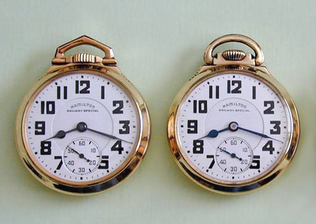

The actual Case 16 is from the 1950s and 1960s and they were marked "Rolled-Gold-Plate in every instance. As if to add additional confusion, in the late 1930s there was a case, identical in appearance to the later Case 16 but like your example it too was 10K Gold-Filled, you may have one of those and absent any other case-screw marks it could be original to your movement, read on. You are likely aware your number C54191 is a 1943 era movement, that is about the time Hamilton ran very low on materials and they are known to have used some odd looking and leftover cases.
I have two such oddities and both those cases are from Star with case numbers not far from yours.
My odd cases are from the same time-frame and are original...
April 17, 2010, 20:17
Eric Unselt
Interesting case on the right, Lindell. The frame looks like a Keystone GF teardrop ...
April 17, 2010, 20:21
Eric Unselt
... while the bow and crown looks like they belong on a Star RGP case.

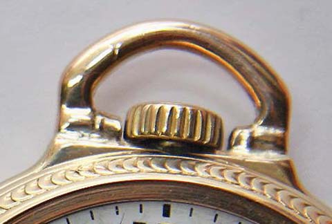

1 of 3

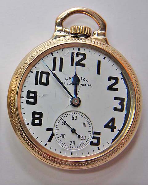

Let's be clear on this, both of those cases I shared above are original, unaltered cases Hamilton issued cases they are entirely original with complete Hamilton and Star markingsjust as they should be.
Anyhow, Larry sent me his images, I believe it to be a leftover "Traffic Special" case used during the World War II shortage of materials I mentioned previously. But unfortunately the case Larry has was altered.
First image shows Larry's case as he found it..
April 18, 2010, 13:43
2 of 3
I called Larry and he sent me his images while we discussed the variants of these cases. When they arrived, the images were very large and I saw what you will all see in the image immediately below.
As the original crown and bow wore out someone at some point in the past replaced the crown with one that is not a very good match and then they gold-soldered the heavily worn bow in place so as to essentially keep it from falling off the case and so they could still use the watch. That explains the "fixed-bail" that Larry referred to meaning the bow was "fixed" which turned out to be the bow was actually soldered in place.
Look closely, the bow is gold-soldered in place...

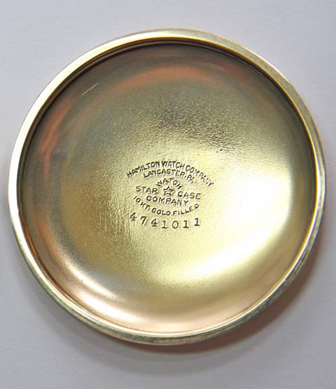

3 of 3
Moving to the case-back, the original markings are there as they should be. Larry confirmed the frame number and bezel numbers match as well. Interestingly, the case number 4741011 on his is fairly close to the two I showed above. On the left number 4704932 and 4704953 is shown on the right. Consider the fact those two cases are so very different yet just twenty-one numbers apart.
Thanks Larry, this turned out to be a very interesting topic.

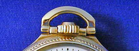

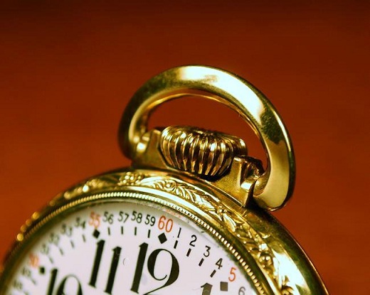

Just to finish this topic and for the record particularly for those who might not be familiar with the Hamilton Case 16 let alone the previous "Traffic Special" here is an image showing an original, unaltered bow and crown. Look closely at the original crown, spacing and relationship to other components.
Bow and crown as they originally appeared...

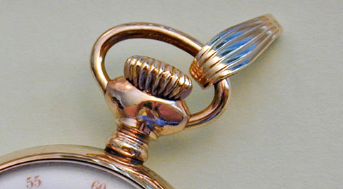

There may be more than one use of the term. Smile For example, I know a "jewelry bail" is the loop that goes over the bow on a small ladies watch so it can then be suspended from a neck chain. They have other uses as well and come in a wide variety of styles.
A "bail" installed on an 0-size pocket watch...
