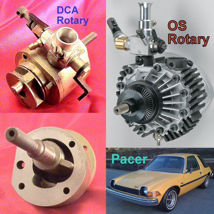

Claude, you are exactly right, the other 50% of the decision by Detroit Automakers to drop the Wankel was Emission and fuel efficiency problems deemed too costly too solve in US-made cars.
Very sadly, the American Motors designed Pacer car that was designed for a GM-developed Wankel failed to "catch on" due to GM's decision to drop Wankel Development, forcing A.M. to use a more costly small six instead. So you had lots of windows but no guts and a higher price point.
My own personal experience with Ford Engine Experimental, GM and Outboard Marine (Johnson/Evinrude?) included trying to evolve a Trochoid-Based rotor setup that could be sealed effectively.
The problem WAS solved by my good friend Kazuhiro Mihara of O.S. (Model Airplane and Steam) Engines, Osaka, Japan, but of course the O.S. Wankels were running on Nitro-based Methanol fuel and had no emissions standards. "Kaz" even worked with me to design and build a simpler working Rotary Super Charger, and Two-stage Supercharged Engine. A business I started in 1986 with a friend that was sadly and suddenly terminated when my friend died of ALS.
