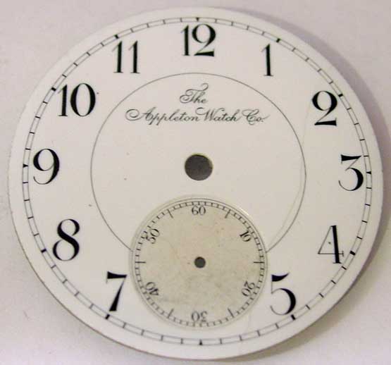

Can anyone tell me what model Waltham this fits The feet are at 12.5 29.5 and 48 it is a 18s dial

I might be wrong but looking up the location of the feet it looks like it is not a Waltham but is a Appleton Watch Co. of Appleton Wisc (1900-1904), they were the Cheshire Watch Co., then Appleton Watch Co., then Newark Watch Co.
It should fit their model 1 or the model 2.
A dial like yours is on page 146 of the 2011 Price Guide.

Oh ok no wonder Thanks Tom

A very common and easy mistake to do since Appleton Watch Co and Appleton, Tracy & Co sound just about the same. A, T &Co used Waltham movements.
Regards, Krister.

Tom is right, definitely an Appleton Watch Co. dial. Does anyone know if they made an higher grade watches?
