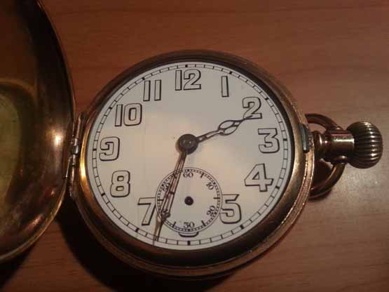

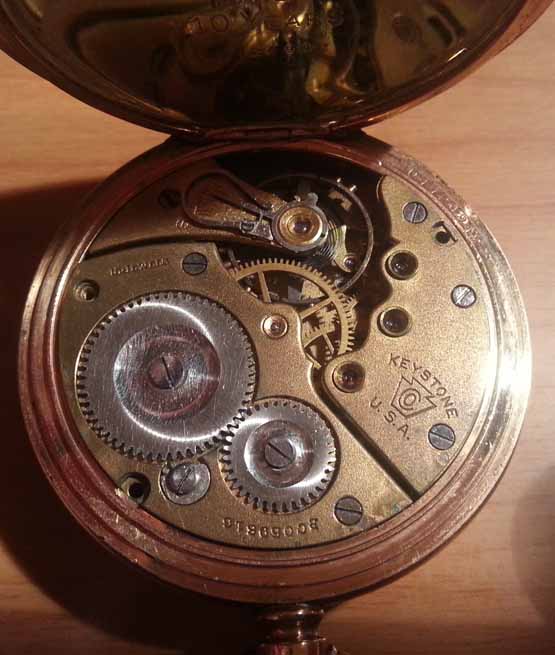

Hi, I picked up this watch recently. I can't find anything about it. It is in a Philedelphia watch case co, full hunter case. The face is unusual. Its made by the keystone watch co USA. Its a 14 size (I think). That's all I know. It as had the screw that holds the hairspring to the balance cock snap off and a bad attempt at repair. The staff is fine and it tries to run when the hairspring is held in place. Id really like to fix it up, so if anybody has a scrap cock lying about, or knows where I could get one........Id be happy to put it to good use.

I looked through the gold book, and found a listing for your watch. It is size 16, 15 jewel, pendant set and was made by New York Standard Watch Co.,model 6. The movement diagram pictured appears identical to the layout of your watch's movement. I hope this helps you. Regarding posting pics, I use the software that came with my camera to resize images.
Gary
September 03, 2013, 04:44
Paul M. WilliamsThanks, that's a great help. There doesn't seem to be any around. I thought it was smaller at 41. 2 ish mm. But I'm still new at this and it does compare to a 16s 1888 waltham and a 17s waltham equity that I have. I found one the same on a site, but can't find it now. What I really need is a scrap movement. Its nothing special I know, but its sort of calling to run again. The plate is almost bronze in appearance. I,ll just keep watching for one. Maybe I will get lucky.

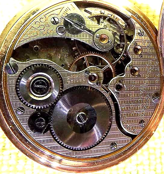

David AbbeYour watch is a New York Standard knockoff of the much nicer quality South Bend Model 1.
NYS/Keystone were well known for copies of other (more expensive) watch layouts. Clearly they hoped to to market these as similar quality by appearance.
September 03, 2013, 18:14
Paul M. WilliamsThanks David, they are very alike. I'm sure many other makers did similar tricks. Maybe that will give me other options to source the part I need.
September 03, 2013, 18:33
Paul M. WilliamsIt is just strange that the castings have been left with the sand finish. It looks almost by design. The face and hand are sort of military in style.
