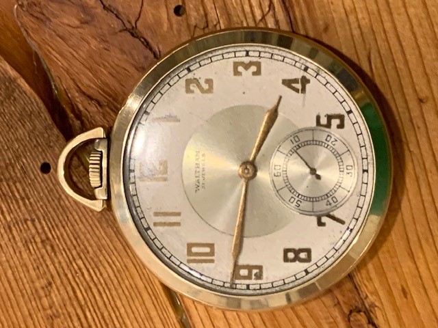

Hello all. I picked up this nice size 12 1936 Waltham Colonial Riverside. There is some dirt on the dial and I wonder if there is guidance on cleaning it. What is the possibility that the dial would be ruined if I tried? Thank you in advance for your help!
dial

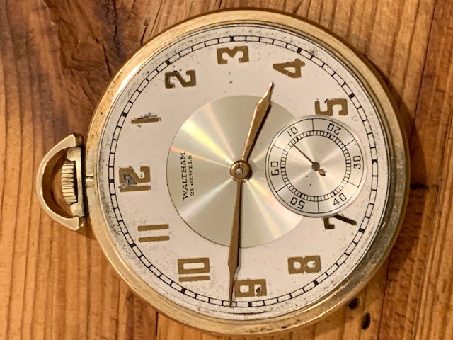

front with bezel
dial and bezel

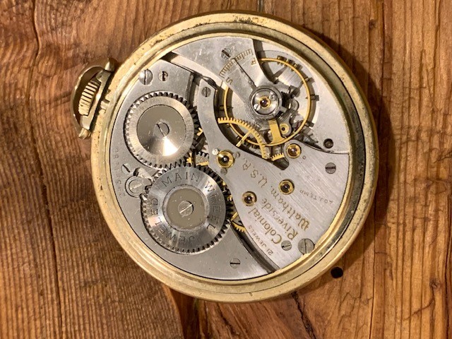

...and the movement
mvmt

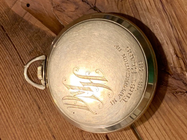

Bonus question. Any guesses on what "First Class" was? Top of the class in school, at work??
back

I've seen far worse dials. I'd leave the dial alone. The only watch dials that can reasonably safely be cleaned are enamel dials. Painted metal dials like your dial are fragile. Anything you do to clean the dial, apart perhaps from very gently brushing away any dust or dirt particles, likely will damage it. The only safe alternative is to find a replacement dial you like. You probably can find one in good condition that isn't too expensive. Because your watch isn't a rare or scarce collector's item, I wouldn't hyperventilate about installing a different style dial that you like. A more expensive and less satisfactory alternative would be for you to have the dial refinished. A few firms specialize in refinishing dials. They usually do a good job, too good a job in my opinion. Refinished dials often look disconcertingly new. Worse, the refinishers have a hard time making dial signatures look original and sometimes they change the fonts or even the design. I speak from considerable hard experience. I now only would have a dial refinished if finding a good, unrefinished replacement dial would be difficult and I cannot stomach the existing dial.

I'm with Ethan. Dial to me isnt that bad and you will ruin it trying to clean. You cant clean a metal dial it is what it is. Leave it be and enjoy it. My .02
