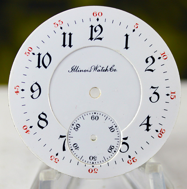

I have this 16s Illinois dial and would like to know what mvmt and time peroid this would have been used on.
Thanks in advance,
Michael
June 08, 2017, 18:23
Michael Barlow
Back side feet at 24.5, 36.5, 55.5 Fits 16s Getty that is all I know
June 08, 2017, 22:13
Tom Dunn
Michael;
That works on any 17J like a 186 3FB or similiar HC or OF
People PUT them on 21J samgamos and A Lincolns but not correct 21J railroads have Illinois Watch Co gothic logo as well...I think the 187 17 Ruby Jewel takes a gothic logo too
Tom Dunn...
TIME MACHINE
www.myrailroadwatch.com
June 09, 2017, 00:51
Michael Barlow
Tom, Thanks for the information. So can I also assume that this is an inappropriate dial for my Sangamo? (No Gothic)
