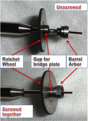

The three screws only hold the jewel setting in place ... good that you took that off. In my case the jewel was easy to take out once the retainer was removed, kept me from breaking the jewel.
If I remember correctly the barrel should just slip right out. The tension from the mainspring will keep it on the barrel arbor, but if you hold the ratchet wheel while "unscrewing" the barrel, you should be able to wiggle the barrel from the barrel bridge and barrel arbor.
If it is like the 952 I have, the barrel arbor unscrews from the ratchet wheel...I do not recommend trying to remove it, unless you plan on replacing it. They are usually very tight from mainspring tension (since mine was broken, I actually had to heat the parts up on the stove to loosen the arbor from the wheel).
DO NOT TAP IT NO MATTER WHAT YOUR URGE MAY BE!!!! Learn from my mistakes! The link below has further info and pictures that might help.
My Hamilton 952 Project Watch
I have a picture of the ratchet wheel and arbor barrel apart as well. There is a picture in the post I sent to you that shows them together on the barrel bridge. Hope this helps.
