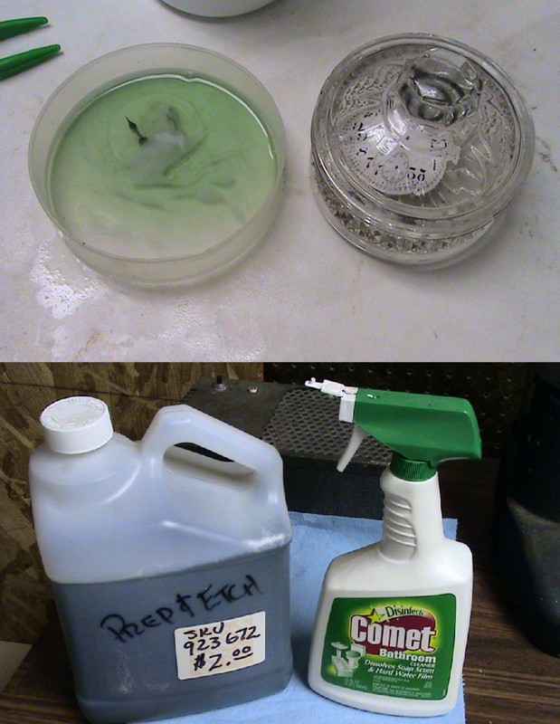

David AbbeIn 2008, I bought a gallon of "Prep and Etch" from Home depot which removes all rust from everything down to watch hands. "Prep and Etch" was formulated to remove metallic oxides from cement driveways and garage floors before they are sealed with Epoxy stuff. After the rust remover has done its job, the metal surface is left with a light grey cast that is easily rubbed off.
It is pictured here de-rusting a set of watch hands. The Home Depot SKU# is on the bottle.
The other is the non-ammoniated, chlorine free bathroom tile cleaner I soak some dials that are clearly coated with ugly, oily, sooty, residue including tars and Nicotine stuff from these early days of freedom prior to the Health Nazi's entering our lives with their dire predictions that living as we had when we were growing up, a person would never pass the age of 10.

David AbbeI bought that at the sale when Home Depot moved their store. The big discount was because it had lost its label.
