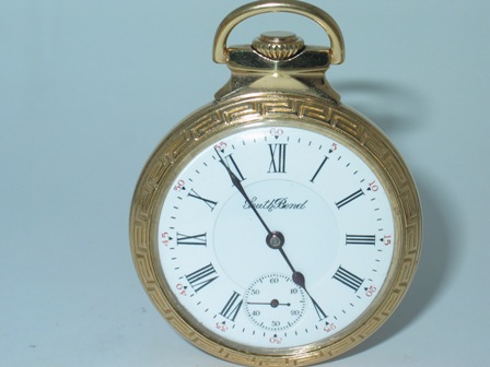

Ethan Lipsig
South Bend Grade 229 "The Studebaker"
As a relatively new collector, I lag far behind all of you in erudition when it comes to knowing whether a watch has been redialed, recased, or otherwise modified. So, with the request that you treat the innocent gently, please let me know what you can tell me about this Grade 229 "The Studebaker," SN 622,386 that I acquired before learning from all the postings to this site how critically important it is that all features of a watch are original. In particular, are the dial, hands, and case correct?
January 10, 2006, 00:31
Ethan Lipsig
Another picture

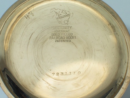

January 10, 2006, 00:33
Ethan Lipsig
Case back

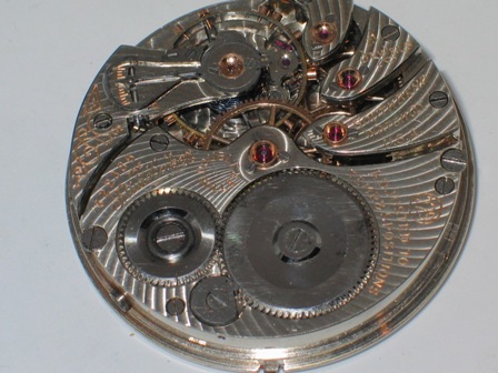

Ethan Lipsig
Movement
January 10, 2006, 02:05
Frank Kusumoto
Ethan,
The only thing I can say with much certainty is that the case is "probably" not the original case. I say that because the movement was produced in the 1910-1912 time frame and the case was produced in the 1925-1928 time frame. All the NAWCo RR Patent cases that I have seen that look to be original combinations are casing later model 227's and Studebaker 16s'. It is "possible" that the case is original, maybe the movement sat around uncased in some corner for several years, but then I would question why a much earlier dial was on the watch.
The hands look okay, the movement looks okay. The dial would usually be Arabic and not Roman numbered but it could be original. The dial looks like a good double-sunk porcelain dial and would be appropriate for any number of higher-grade South Bend movements made in the 1908 - 1914 time frame. I am by no means an expert at these things so please take what I say as just my personal assessment. The last time I saw this particular watch was on Ebay. It went for $712 on Jan. 12th of '05.

January 10, 2006, 07:12
Terry Hill
are there multiple case screw marks in the case?
January 10, 2006, 10:45
Ethan Lipsig
Thank you Terry and Frank for responding. Terry, there are no screw marks that would suggest the case had been used for another movement. Frank, I am relieved to hear that the watch may not be as odd an assemblage of bits and pieces as I feared. You are correct that I paid $712 for this watch when I purchased it on eBay, but I bought it in 2004, not 2005, according to my records.

January 10, 2006, 13:46
Terry Hill
that is good news... some possiblity this could be either an original... or an original recase... but not much of a way of proving...
is the lever slot exceptionally wide?
January 10, 2006, 21:52
Ethan Lipsig
Terry, the lever slot does seem unusally wide, about 3/8". In addition, it is bisected by a flange against which the lever rests when fully extended.
January 10, 2006, 23:32
Terry Hill
like a 'dual' slot?
this still does not completely rule out it not being original... if these cases were factory furnished with a 6 minute lever slot....
and additional slot would be necessary for the SB movement.
January 11, 2006, 00:19
Ethan Lipsig
Yes, Terry, it looks like the watch has a dual slot separated by what I had referred to as a "flange," with the lower slot being used for the lever and the higher one at "6" not being used at all. I am attaching a photograph that shows this.
But what does the existence of this dual slot tell you?
January 11, 2006, 03:28
Frank Kusumoto
Ethan,
With no extra screw marks it makes it look like an "original" recase. Also, quite possibly, the case originally had a 16S Mail-Order Studebaker and then was modified for the 229.

January 11, 2006, 07:15
Terry Hill
That is one possibility ... the mail order was a pendant set...
what does the slot tell me.... Frank pretty well covered that in a short sentence...
If the case had the lever slot at the 6 minute mark cut at the factory, then when this movement was placed the additional cut would be necessary... the lack of additional case screw marks makes this being an original recase plausable, but not provable...
i doubt there would ever be evidence to fully prove it original.
hey.. it faces up nicely, and is a fairly uncommon movement.... though they regularly change hands..
i can accept it for what it is.

I have on hand any part needed to repair a SB 229. It's not a problem if you collect parts and parts watches. The only part unique to the watch that is hard to find and practically impossible to replicate is the ratchet wheel. There are hundreds of reasons a watch might not time out in all positions totally unrelated to the "unoriginality" of the parts. From the pic the train and jewel settings look correct and any incorrect screws can be easily replaced. Of course my eyes are not what they used to be. Big Grin

Speaking of likelihood, I too see your watch as a very unlikely combination. One thing to consider is the fact that South-Bend dials interchange between Open-Face and Hunter-Case movements. A dial such as this is usually associated with a hunter. Few if any buyers would choose a Roman dial for a watch that was one of the finest Railroad watches available at the 1910-12 time-frame when these watches were very popular. And as Frank pointed out that signed in script writing South-Bend dial design is a bit early for your movement.
In looking at the case-screw marks consider this, the case-screw marks for the second model South-Bend movements line up with those of a 16-size Illinois in the instance of all the non-Getty Open-Face models. With an Illinois the lever-cut is at 6-minutes past the hour whereas South-Bend is at about 8-minutes. One very distinct possibility would be the case in question may have previously held an Illinois movement. Accepting that possibility could easily explain the lack of additional case-screw marks and the extra lever-cut as well
South-Bend did sell this style of case from the factory with both Mail-Order-Studebaker Pendant-Set movements as well as Grade 227 Lever-Set movements. A mail-order watch could have been the original occupant as the case screw marks would be as Frank pointed out be in the same positions. Some of the Mail-Order-Studebakers did come in cases with a 6-minute lever-cut. Since the bezel would not normally be removed that did not matter and that allowed them to use what were essentially left-over cases as a cost-cutting measure.
Any way you slice it, that movement did not originally come in that case. No offense, but my personal opinion is the watch in question is probably a recently a put-together assembly of leftovers. If it were in my collection like Frank and Terry I'd want a railroad dial on that railroad movement. And I'd also want to put the resulting combination in an appropriate period-correct high-pendant case from around that 1910-12 time frame in which the movement was produced. For additional information and advertising showing your movement, hands, dial and case in the correct time context our "South-Bend Research Forum" that Frank maintains is a great free-to-the-world resource.
If it's any consolation, all three hands are entirely correct. Big Grin
