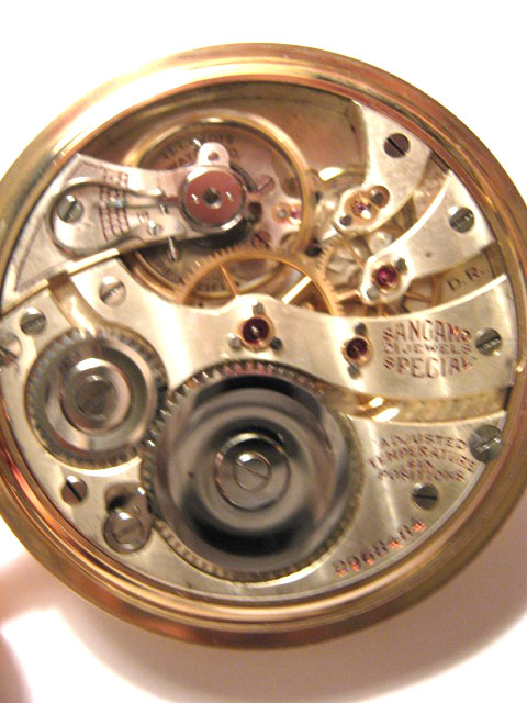

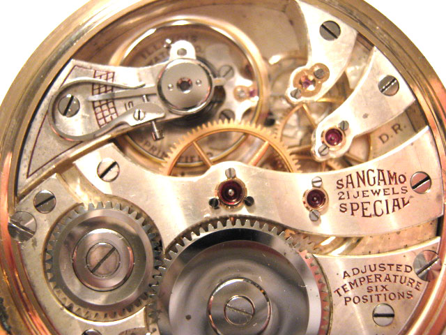

Sangamo 21j Special
Serial # 2968484

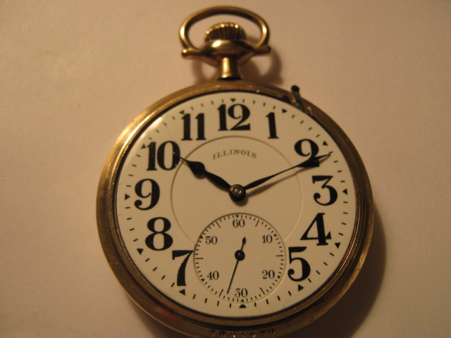

Would this be the correct case, dial, and hand combo?

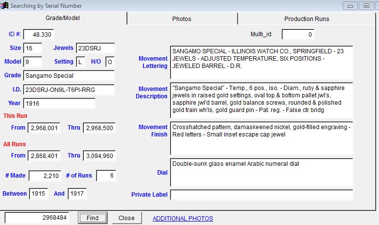

quote:
2968484
Odd that when I run the number, it comes up as a 23J.

Dial looks good hands are wrong. Should be Illinois kite hands.

The Illinois Blue book list it as a 21 jewel with 3350 made.

21 JEWEL SANGAMO SPECIAL - FALSE BRIDGE
YEAR_______RUN________SERIAL_NUMBER_______QUANTITY
1915
_____________20________(2,835,771-2,835,800)____________30
1916
_____________25________(2,968,001-2,968,500)___________500
1918
_____________32________(3,251,001-3,251,400)___________400
NOTES:
(1)Enamel inlay markings on the movement come in: gold, red, or other?
(2)All "Broad Transverse Band" demaskeen pattern.
(3)Total production 930 all model 9.
(4)Not marked "Jeweled Barrel".

I stand corrected. It should have a straight line Illinois dial

When I run the s/n on the Pocket Watch Database it comes up as 21 jewels mod.9.
