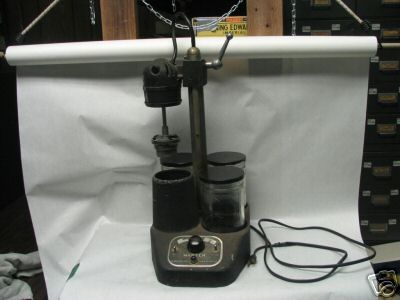

L&R Auto-Reversing Spin cleaner. L&R Fine watch cleaner and L&R #3 (I think) Rinse. Swiss Air dryer.
December 30, 2012, 11:19
Joseph Boone
David, I have that same machine.

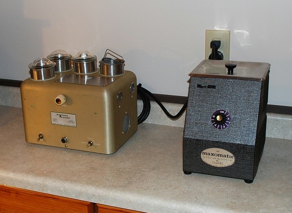

I use a McKenna ultrasonic with a built-in dryer. I takes up far less room than the L&R #3, uses far less fluid, and doesn't make a mess.
On the right is an L&R ultrasonic that I use for cases.

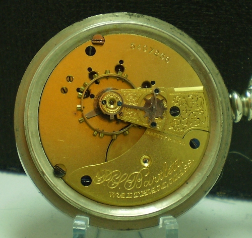

Have you used your solution to do guilded movements? I have a couple of guilded watches that have become dingy over time. Lookin for something that will bring out the color again.

I have Bruce. Gilded plates and brass is something it does well. But as you know some plates will never be what they once were. Here is a 18s that was cleaned with the solution.
