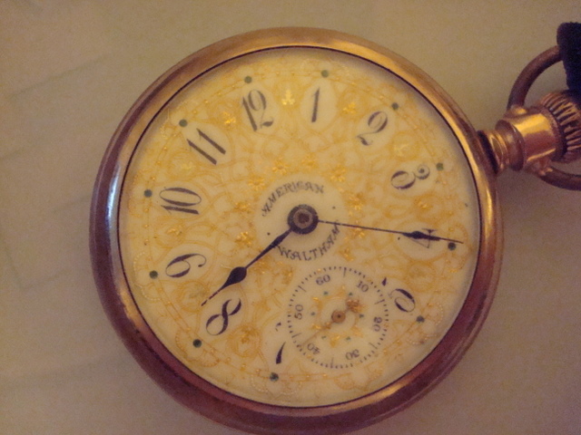

I have a pocketwatch I received from my brother. It is American Waltham pocket watchm, size 18. It may have been made in 1898, and he was told it was a railroad watch. Your comments about it would be greatly appreciated. Many thanks in advance.

Tom Bruntonyou'll need to unscrew the back and post a picture of the movement to determine if it's RR grade though with your ultra spectacular dial I suspect not, as the vast majority of RR dials were white with black lettering. I'm almost sure that yours is an O'Hara dial,very scarce and desirable
August 30, 2011, 23:42
David Abbeohmigod! More pic's please!
August 31, 2011, 01:05
Robert V. JonesI agree this looks to be a O hara dial but it surely is not a rr grade watch which may not be all bad!!
August 31, 2011, 15:51
Roger J. NolfeNote also that it is a sidewinder, indicating it is a hunter movement which would also preclude it from being a RR watch. Beautiful dial!
August 31, 2011, 17:18
Tom Bruntonmight be a 21 jewel 5 adjustment -railroad grade but not railroad approved ,though far more likely a 7 jewel

Eric UnseltI'm with Tom - the majority of fancy dials front low-end movements.
September 03, 2011, 14:05
Jerry KingI agree with Tom and Eric regarding the fancy dials, however, it ain't
always the case as with my Elgin BWR....but more cases than not the fancy dials are on 7 - 11 jewel movements....

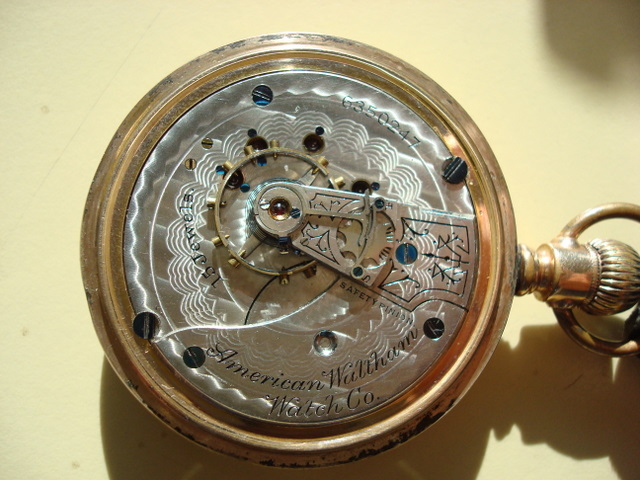

Paul Rudolph MillerHere is a picture of the movement. It is 15 jewels. It is my dad's watch, and my brother thinks he may have bought it in the 1930s. (I think he may have won it in a poker game!) The gold plating on the back has been worn through to the brass case. The inside of the back case read "Fahys, Montaux, Guaranteed 20 years." The serial number of the movement is 6350247, which puts it to 1893. Thanks for all of your comments.

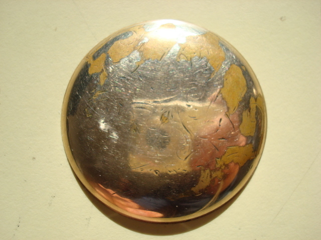

Paul Rudolph MillerAnd here is a picture of the back of the case.

Buster BeckAs a heirloomed treasure, it is a great watch !!
As to evaluating it, it will depend on whether the dial is signed on the back by the dial maker.
This type of porcelain dial is extremely fragile, almost like an eggshell. I caution you to remove the hands super carefully and to REMOVE the dial screws completely before the disassemble.
IMHO I think it would be great to find a real nice H/C to put it in and to find out if it's in fact a signed dial. I don't believe that would take away from the memories of your father that it once belonged to. It would only heighten the emotions knowing that I had put it back in it's original configuration and could be truly appreciated for a daily or occasional carry watch. Every time I pulled it out, it would memorialize those fonder times when "family" was king ..........
