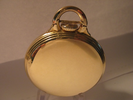

I was offered this Hamilton for $200, so we haggled for less, and a 992E gets added to the pile:

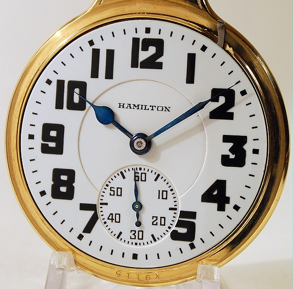

It had one of those horrible yellow plastic crystals, and that got replaced in a hurry (thanks, Mike Smile).
The hands suffered greatly from that crappy crystal, so I sanded them down, buffed them out, and re-blued them. I could've bought a better set, but I wanted to keep the originals with the watch.
A flawless porcelain-enamel dial:

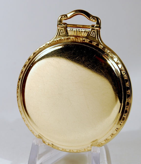

I'm thinking this is a Model 2 case, right?
Wadsworth SN H359115.

I was thinking about putting my case-less 992E in a model 10, but after seeing yours in that model 2.... I think I'm gonna try to find a model 2.. Gorgeous watch!

Very nice watch. I love the #2 and #8 cases above all others. Nice find!

Whatever choice you make in cases and movement marriages, try and keep in mind to make it "era correct".
By using the link/charts below one can see that Eric's movement would require an "H400,000 to H499,999" serial numbered case and Bruce's movement would require an "H300,000 to H399,999" serial numbered case. Please note that Eric's case could be correct since the case was made in 1939 and cases and other materials were "stockpiled" by Hamilton in bins and to assemble a watch, a needed part was simply grabbed from the bin. As long as a case is a year or two earlier, this would hold true BUT if the case were "later", then there is a problem with documenting the combination for the most part.
When assembling cases and movements today, one should try and not throw up red flags where none are needed and may not be accepted by a prospective buyer at a later time.

The Model 10 (a little to harder to find than the number 2 BOC) case can be a nice fit for the 992E movement, if the year of the case can be matched up to the movement year, imho

That's not much of a watch, but the crystal is sure nice! LOL Great pick Eric
