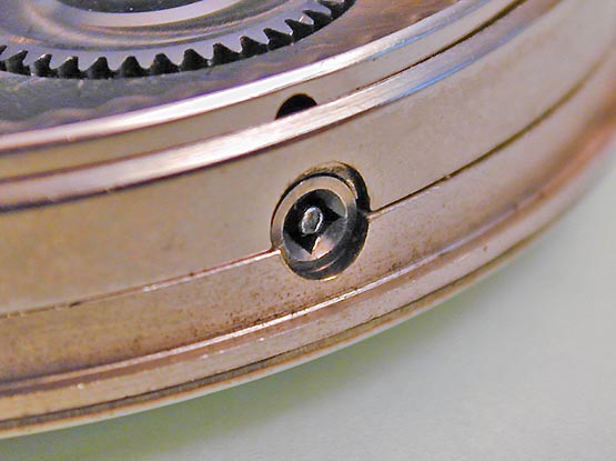

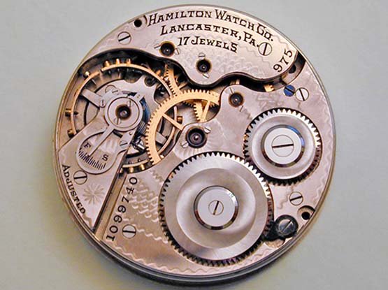

Reading that information I am not so sure Mark's movement has a detent system. I'm no "expert" but unless I've missed the boat on these, I seem to recall that only the earliest Grade 975 movements would feature a detent. Mark's number 1347778 is from a 975P (of course, the "P" means pendant-set) run that numbered 1346001-1348000 during 1919 production. In looking into this and in an attempt at helping sort this out I just examined 1099740 which is a 975P that I have which is from 1915 production and it does not have a detent. The next two illustrations will show some details of that particular movement that may prove to be of help.
Mark, compare your 975 movement to this one...
October 30, 2006, 15:50
In that first image above you see movement 1099740 which is from four years before Mark's and does not have a detent screw. If it had a detent screw, then I believe it would be located near the crown wheel along the edge of the movement. Since the number on mine is just a bit lower than Mark's my thinking is the two movements may be essentially similar, perhaps identical in their design and therefore may be cased in the same way.
Look very closely at the image below. You can see the square hole where you would insert a stem. But there is also a spring-loaded device in the center of the hole that pushes in when the stem is inserted. Seeing that may at first cause some confusion. But note also the normal square hole to insert a standard stem. If Mark's movement is like this one, even though it looks unusual a standard 16-size case will work just fine.
Perhaps others with more practical repair experience than I can explain this further.
Carefully examine the image below for details...

Lindell...that's EXACTLY what I'm seeing in the staff hole. Eek
So, apparently all I need to do is come up with a case with a properly depthed staff to wind and set the watch...right?
Great shots! Demonstrates exactly what I see in the opening of my watch!!
Thank you VERY much Jim Cope, for your kind offer. Looks like I don't have a problem after all. Smile

Looks like you got lucky Mark, your movement should be no problem to case.
If it's a good looking movement, hands and dial one cost-effective choice might be a Hamilton display case. Since yours is a pendant-set movement that would allow you to use, and for that matter even carefully carry your watch occasionally without needing to remove the bezel.
