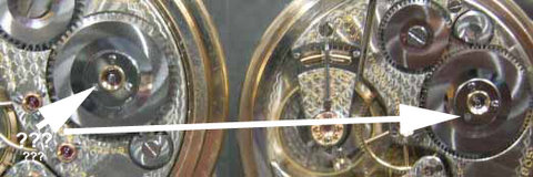

But I have a new #2 question and it may not be Dum Dum. That is why are 9 out of 10 Jeweled Motor Barrels I work on fitted with at least 1 non-matching replacement screw?
March 12, 2008, 01:35
Well David, the first answer probably is that is what they have available and they do not know better. Roll Eyes
The answer to your second question is equally sad because there is really no reason to remove those screws during normal service but evidently most people do. My feeling is on the "odd" screws we see is simply from clumsily losing one due to their small size. Finding proper replacements can be tricky! When I have been able to replace all three then I have spares for the next two watches.
March 12, 2008, 02:04
Frank Kusumoto
They break off half of the head of the screw OR they strip the thread OR they lose one.
March 12, 2008, 02:10
Frank, I have a few that are broken too. Lindell, I think that Godzilla must have been teaching some of the earlier Watch Repair classes and these "students" who went on to work on watches after they were taught on big tower clocks. Clearly these people did not understand the difference between a retainer screw and a structural bolt.
