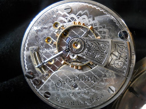

Hey there! My father-in-law sent this to me a couple of years ago. It belonged to his grandfather. It's an Elgin, grade 353 "Overland", 17 jewel adjusted, railroad watch. When I got it, it was missing one hand, and was needing a cleaning. It ran strong though. I bought a new pair of hands from Otto Frei, and had our village watchmaker service it. Well, it doesn't run worth beans. It runs great when on its' back, but, when it's upright, it stops. Balance staff? And I noticed just now, after photographing it, that it wouldn't start running until almost completely wound. Any ideas? Regards, Brad

Hey all! I was just noticing the movement on my Elgin, and remembered a post I read a while back in the Pitfalls section. There was an Elgin shown, and someone posted that the balance cock wasn't indigenous to that watch because the engraving pattern on the cock didn't match the plates. Mine looks just like that! Confused Was that normal for Elgin? Brad

Brad,
I don't know if it is the picture or what, but it looks like the hairspring is going over the top of the regulator arm instead of under it. It should be under and the outer coil should be between the two small brass pins under the regulator arm.

Hi Roger! After reading your post, and looking at the picture, I got out Mr. Loupe to check! It's just a reflection in the photo. I also looked under the regulator arm, and the outer hairspring is between the two pins. But thanks for bringing it to my attention. Regards, Brad

Glad it was OK Brad. If it wasn't I would have suggested you immediately retrieve your 974. Smile
As long as you have a loupe, you might want to take a look at the hairspring in relation to the arms of the balance wheel. Make sure it is not making contact anyplace where it shouldn't. Also make sure all the coils are separated and not touching each other at any location. The smallest bit of oil on a hairspring will cause problems.
You have a very nice watch there. They are very reliable and relatively easy to repair.
