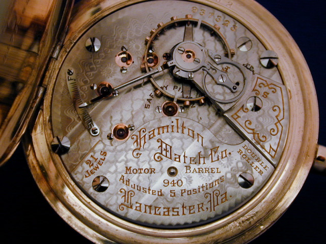

But seriously, I can tell you the thing looked recent to me simply based on the way it was done. From time to time some crudely marked movement shows up on eBay. This seller avoided mentioning it, but others have had speculation about "The Railroad" or "The Inspector" adding "Special" or "Extra" or grade numbers to the movement when to me they look like recent additions done at the local shopping mall.
My understanding is when the "Marked Movement" rule came into play those unmarked movements in RR time service were "grand-fathered" meaning they were accepted as long as they passed inspection requirements. Newly purchased watches entering time service had to be marked with the grade, and I'd sure think that meant factory marked rather than scratched with a pocket-knife at someone's kitchen table.
Story goes that Hamilton would add the grade number to movements sent in for factory service. Perhaps, and I'd also believe they would have added the grade or other markings to unsold movements still in factory inventory. Those would certainly have the same basic look as factory production work. I don't buy the stories we hear about the crude looking additions any more than I'd accept an altered serial number.
Let me be clear on this, I'm not accusing the seller in the subject auction of anything improper, I would have no reason to. But frankly for my money I want a correctly marked movement or I don't want it at all.
The artistically rendered Hamilton factory markings would be very difficult to falsify...

Thanks guys! I imagine that oxidation and dirt could represent 5 years or 105, absence of oxidation and dirt could represent recent service, a bit less crisp could represent careless service. I bet Larry’s right on when he says he’s not sure you could tell if the engraving on a movement is old or current, unless as Lindell illustrates so well it's factory-original.
