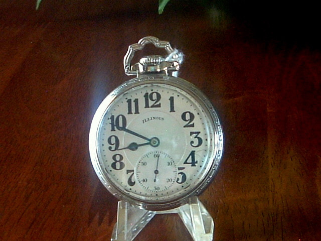

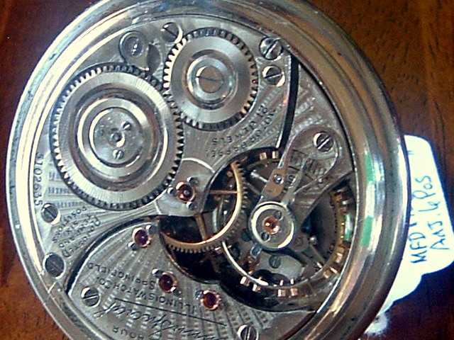

Just got this 21j.Motor barrel,s/n5102635 in a Bunn Special Model case s/n 7279555 14kgf Wadsworth.Dial #114 has a few hairlines should soak out.My concern is the hands.Are they correct?Altough I have seen this combination before.I believe the movt.is circa 1928.Any comments appreciated.

Nice watch Roger.
Check this link out.
I think once you change the seconds hand you will be in business, well almost anyways Eek
Now we need to put the correct 1st Model Bunn Special "chain link" bow on your case and take the Model 193 bow off.
I will send you an email.

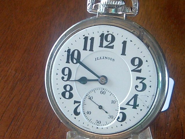

Thanks Buster,I wasn't aware that the bow was wrong.I cleaned the dial,cleaned up really well,replaced the hands with a complete set of "wine" hands. More to my liking and still be correct I think.
