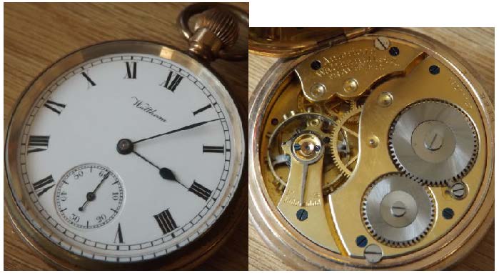

Waltham Traveler Ser.19,211,147 (c.1913): The watch winds smoothly, ticks beautifully, but I cannot pull out the crown to set the time! I apply up to around 4 lbs force at various crown positions, but there seems to be no available "slot" for pulling out the stem.
What could be the problem here?

This is my fourth Waltham Traveler of the same period, and I can assure you, all are stem set. Also, the setting is done by pulling the crown outwards, not pushing inwards.

To detail the behavior even more, the crown will not "pop" out at all. It will move slightly inwards when pushed and then spring back out. The crown rotates normally and winds smoothly, but the slightest movement outwards is not possible.
