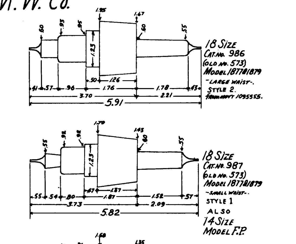

Thank you David. I need info about staffs used on this model.
Thank you.
Bulent
October 07, 2009, 18:53
Brian C.
Bulent,
The book lists two staffs, #986 Large waist and #987 Small waist.
October 07, 2009, 19:22
These are the 986 and 987 dimensions in mm (I guess?).

By Gollies, where else could you get this type information so quickly....WHAT A CLUB!!!! & IT'S MEMBERS....
You can order them from Brian C. or make them yourself and I have a feeling you will make them.... Big Grin
Good luck, either way Bulent....
