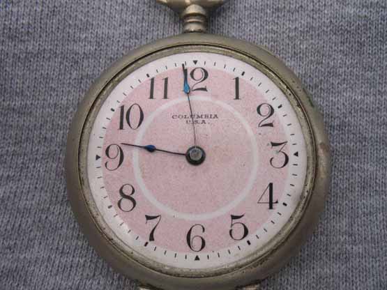

I did get some photos. It is not cleaned up yet, but you can see what it is. I am on an RV trip on the Oregon coast and don't have my stuff with me.

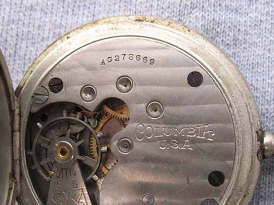

The movement

Hey Mike, Looks like you got a New York Standard Columbia.
June 30, 2011, 11:46
Mike Hodge
Thanks everyone, Cecil, does the New York Standard designation make this better, or worse? Like I said, I am away on a trip and have very few reference materials with me.
June 30, 2011, 15:57
Cecil McGee
Hey Mike, The Price Guide lists that watch only as 6 size,model 44,and only as hunting cased,and looking at the movement in the book,looks like NYS made a dial without a second hand so they could use that movement either way. It is listed at $55-$70-$100 in the book,and there is a notation that O'Hara multicolored dial adds $75-$100 to value. If I read that right it makes the low book $130. I really don't think those watches sell for that much,but as always,it is only worth what you can get for it.

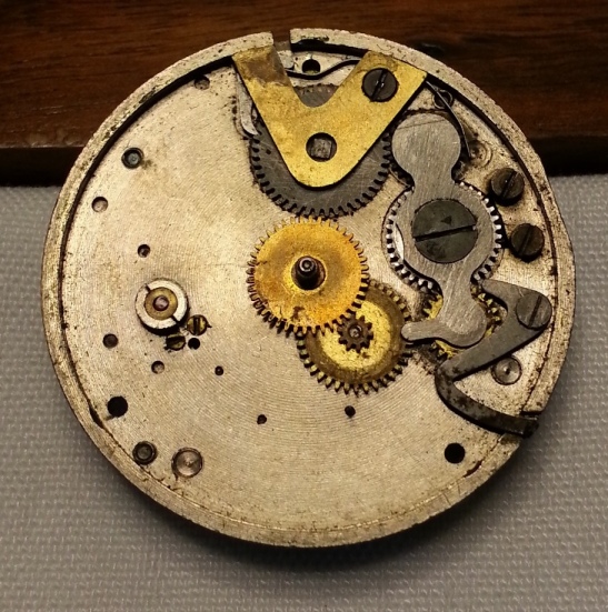

I went through one of these Columbia's today for a friend from work. The fit and finish is pretty crude compared to the other watches I've been working on.
Setting the bridge with all five shafts coming through one plate was easier than I expected with the pillar style plate and not having to worry about the pallet.
I've seen this wind set mechanism layout before, but for the life of me don't remember if it was an old Hampden 18S or another I was in to a few months back.
For the record, a Waltham 12S Col. B Main spring #2237 .015 was a perfect drop in replacement.
Other than that, she was over banked and needed a crystal... the rest was clean lube.

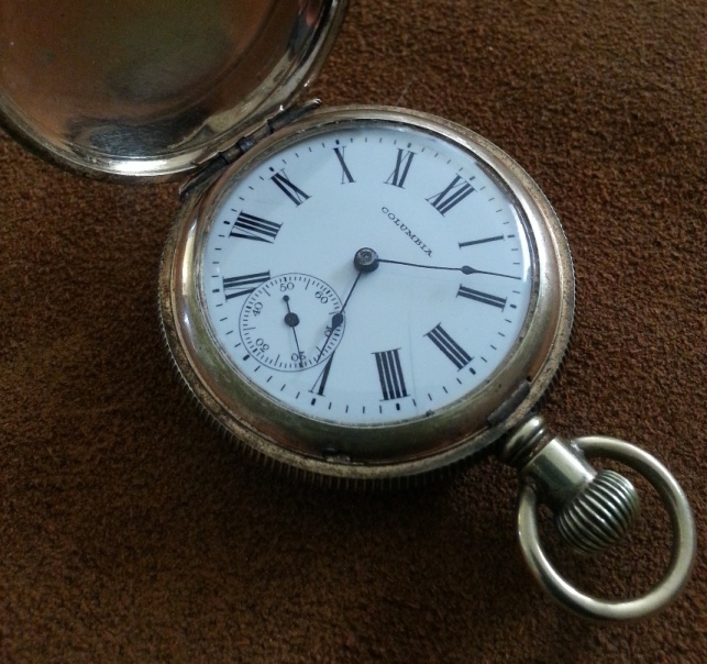

The dial has one light hairline... I believe the watch is 100% original.

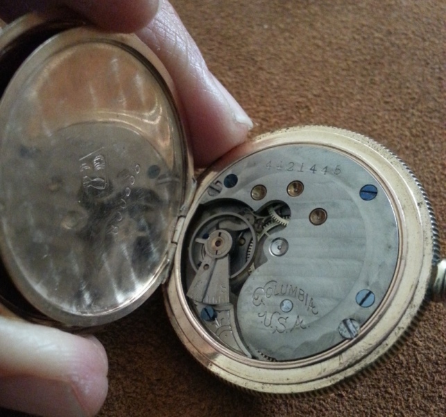

4 Jewels? The only jewels in the entire watch are capped balance jewels... and these are extremely odd pressed in, one piece units.
Cool Arm and Hammer stamp. The case confused me, I though it was a brass case, but after hitting it with metal polish, the inside covers, covette... all looked to be ygf... so, the Arm and Hammer posts here suggest it is very early gold plating process... all the outsides are down to brass all the way around... inside is still plated.
