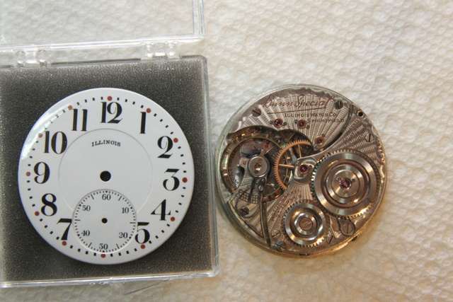

Can anyone tell me if this is the correct dial for this movement?
It has this same dial on it now with hairlines, and my customer just wants me to replace it with this one. I thought it went on the Lincoln type movements, but not sure.
Thank you for any help.

No this would not been the original style dial that would of been on this Bunn.
March 18, 2013, 22:05
Larry, my understanding is the Red Dot dials are for movements with fewer than RR spec adjustments.

Thank you guys.
Come to think of it I have a wolverine Illinois with this dial also.
My suspensions were correct.
I appreciate your help.

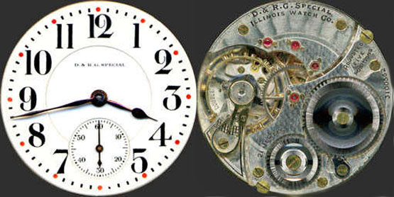

The red dot dials were found on D&RG RR A.Lincolns grade, here pictures of one of these:
