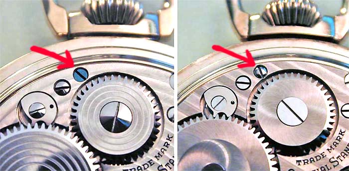

As Wayne mentioned, this question about "the little blue screw" came up in one of our "Avoiding the Pitfalls of On-Line Trading" topics recently. Wayne, whether or not your dial is loose, perhaps something else is broken, loose misadjusted or missing remains to be seen at this point.
The photo-merge below this post show both styles of screw that threads into the setting lever. Early movements such as 1B188 shown on the left use a blued, flat-headed screw, in later movements we find they used a domed-head, polished screw as shown on the right. In each instance this head is the opposite design from other screws in the movement.
This little screw is common to every Hamilton 992B and 950B as well as Ball-Hamilton 999B movement. You will also find it on the Military 992B, 2974B, 3992B and 4992B movements, in other words any movement derived from the 992B design whether Lever-Set or not. With the Pendant-Set military hack-setting movements, this screw holds a retainer in place.
Early lever-setting retainer screws are blued, later they were polished...

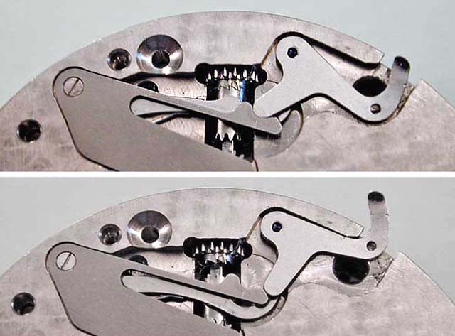

Here are some pictures of Wayne's beautiful Hamilton 992B in the Two-Tone Case Number 3 from 1946 which consists of a Yellow-Gold-Filled Frame with Stainless-Steel Back and Bezel.
In the first photo-merge below you see details of the clutch mechanism that selects between winding with the lever-in and setting with the lever pulled to the out position.
Having this complication well-lubricated is important to smooth operation.

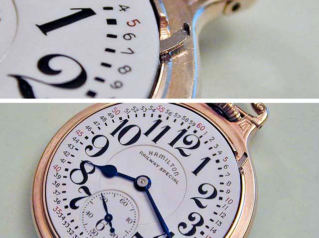

I found the dial feet were a bit long which was causing the dial to not fit down flat against the pillar-plate. Filing the feet shorter was an important step in straightening out Wayne's watch.
Then I actually bent the lever slightly forward to allow easier access when pulling it out. Reinstalling the lever and dial we have a nice fit as shown in the upper image below.
Next step was to fit the new seconds hand as shown in the lower image.

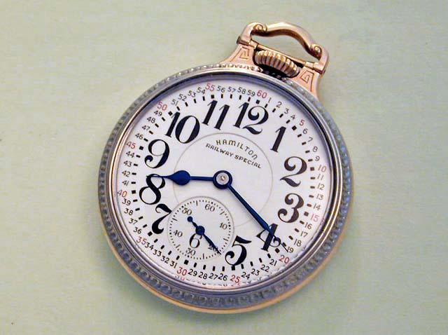

I could not resist replacing the plastic crystal that was on the watch with a new-old-stock glass crystal. Smile And so now you see the finished product below. Wink I think Wayne will be pleased.
Finally, Wayne Hanley's 992B is ready for the trip home to California...
