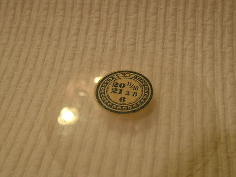

Thanks Dave. I am always fitting hunter cases with crystals and the labels have 3 numbers on them. I thought they were called Geneva crystals for some reason. I know the bottom number is height and I think the top one has to be the diameter where they seat but what is does the middle number mean? Hasn't ever made much difference when I just go through mine and find a good fit but now I am trying to tell somebody what I want. Thank you for the chart

Robert, the crystal sizing numbers you refer to including a "middle" number are puzzling. I am used to a top number and a bottom number on the crystal label. The top being the diameter according to the chart, and the bottom having to do with the dome height. For example, the 20 8/16 foreground crystal (below) would be 1.822 Inches in Diameter and have a "dome" of 21 (somethings).

Sorry it took me so long to reply Dave. Things have been hectic. I still haven't aced Picasa yet, to put it mildly Roll Eyes, but I did figure out how to resize a picture again so I am attaching one of the labels I am talking about. Thanks for your invaluable input!

WOW! I hope someone can help with this dome measurement thing. I thought the higher the number the lower the dome, but who knows.
